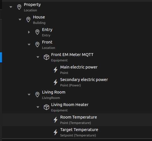

I have the following model tree:
For Main electric power, Secondary electric power, Room Temperature, and Target Temperature, there are no settings that reference persistence.
Despite this, clicking on these items always displays an empty graph. Where am I going wrong? What else should I provide to help troubleshoot this issue?
