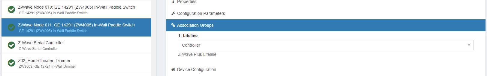

Unfortunately the setup has stopped working, possibly due to a power outage? For the life of me I can’t get it working again. Is there supposed to be a valid way to configure this? It looks like there is only one association group for the lifeline, so I’m not sure thats usable? Furthermore I don’t see any events when i manually toggle the switches so I’m not sure if I could write a rule either. The setup does work if i toggle either switch from a GUI, since one is following the other.

The 2.4 version of the zwave binding has an issue where associations can get lost, which sounds like the issue you have. Reapply the associations, even if the UI is displaying them. Only use Habmin to configure your zwave devices… Paper UI can cause issues. In 2.5, associations are being forced, to ensure they didn’t get lost.
So I removed and readded the two Switches since I could not get the pending message to go away when associating the lifeline group.
After readding them and associating the controller to the lifeline group (because I can’t associate them to eachother correct?) I still don’t see messages in my logs with INFO enabled when actuating the physical switches.

I was able to get it working. I suppose the reason I wasn’t seeing any updates this time around was because i had not yet added any items to the things. Once I mapped an item to the channels the logging began showing updates from physical actuations. At that point I used paperui to create a follow channel profile that follows the noload switch item. I’ll have to look into using follow profiles in the .items file instead of paperui to see if that sticks better.
