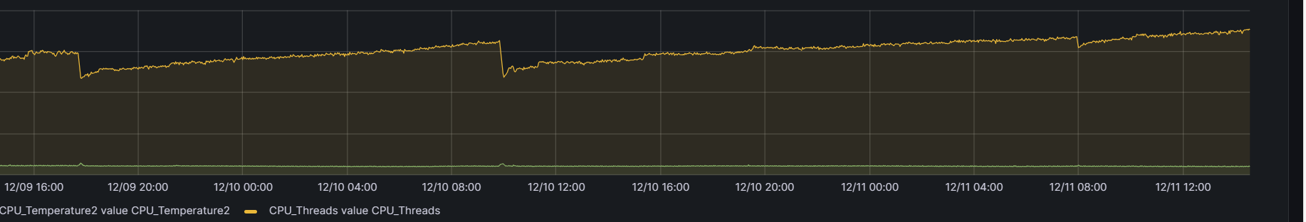

Hi Eric,
My treads are rizing and they keep on rizing. so i asked in a blog and the first thing they said that the use of old bindig files could be problematic. So I want to be sure that the binding isn’t the problem.

Well if it is indeed causing the issue with your CPU threads I suspect it needs some more work than only a recompile. Still have to upgrade my openHAB to 4, work was taking a bit over last half or the year, should be a bit more manageable in the near future, then I’ll upgrade it and make a OH4 version

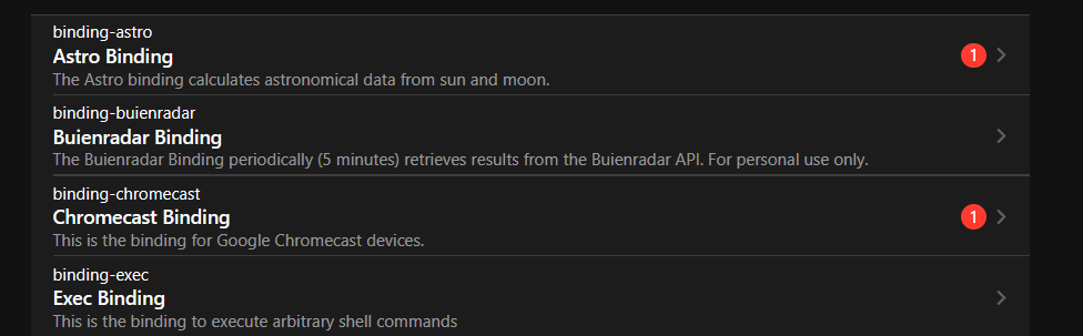

I tried to put the jar in addons folder on my OH4 systema but nothing happens. How did you manage to make it work?
Idd i don’t see the binding in my list either. But it is still working.
so there will idd more work then only a rebuild…
Same here. Drop the jar file in the addons folder and nothing happened

It looks like actually everything still works when using the old plugin with openHab 4, except it doesn’t list the binding anymore, so you can’t make a new Thing anymore. (so it keeps working if you upgrade from an older openHab, but you can’t add new ones)
