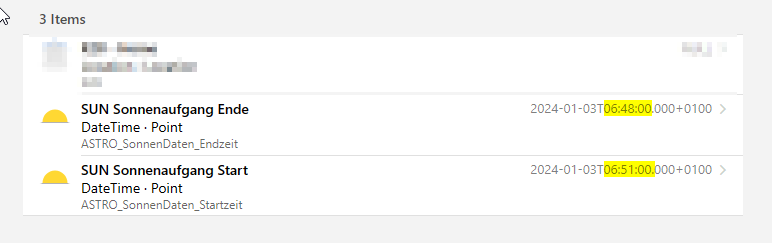

All my sunrise, sunset, civil, natic, etc. datetime items are exchanged.
That means the beginning of the sunset is after the end:
e.g.
2024-01-03 12:58:46.420 [INFO ] [openhab.event.ItemStateChangedEvent ] - Item 'ASTRO_SonnenDaten_Start' changed from NULL to 2024-01-03T06:51:00.000+0100
2024-01-03 12:59:53.369 [INFO ] [openhab.event.ItemStateChangedEvent ] - Item 'ASTRO_SonnenDaten_End' changed from NULL to 2024-01-03T06:48:00.000+0100

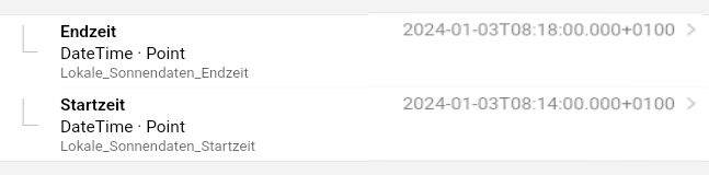

before I started whith my astro-item-file, I generated two items on the web-console:
Where’s the error? Somebody any hints or ideas?

during anonymizing my geolocation, i was struggling about the value…
I should have double check it before!
Sorry for that. correction of geo-data brings correct values for start- and end-time.
