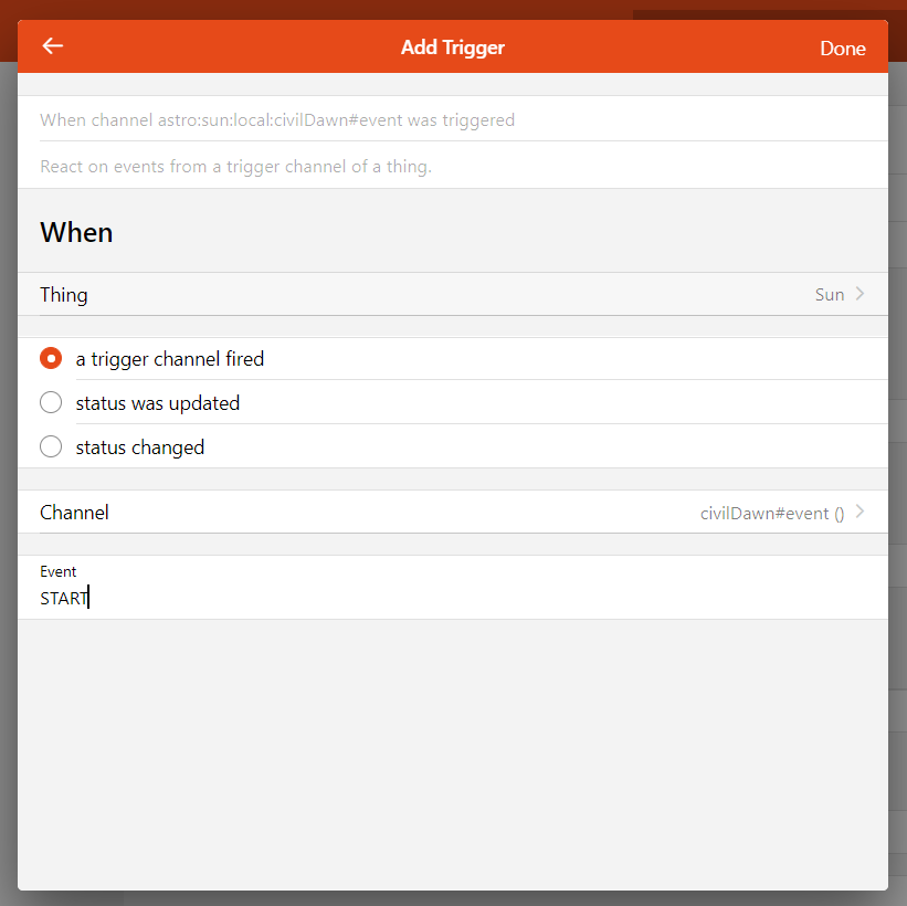

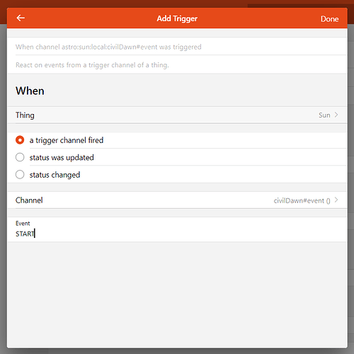

What you need to do to achieve your goal is to create a rule, with a trigger like this (Select Thing Event):
(Note the START at the bottom, the trigger channels fire two events START and END, if you leave the field empty it will fire twice, so put either of them there)

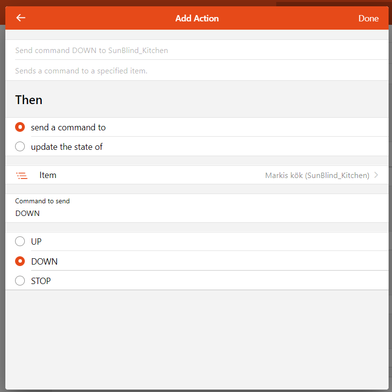

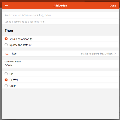

And an action (Item Action):
Thanks a lot! The event line is indeed the only one that was not self-explanatory for me and I had to search in the docs for the possible events.
