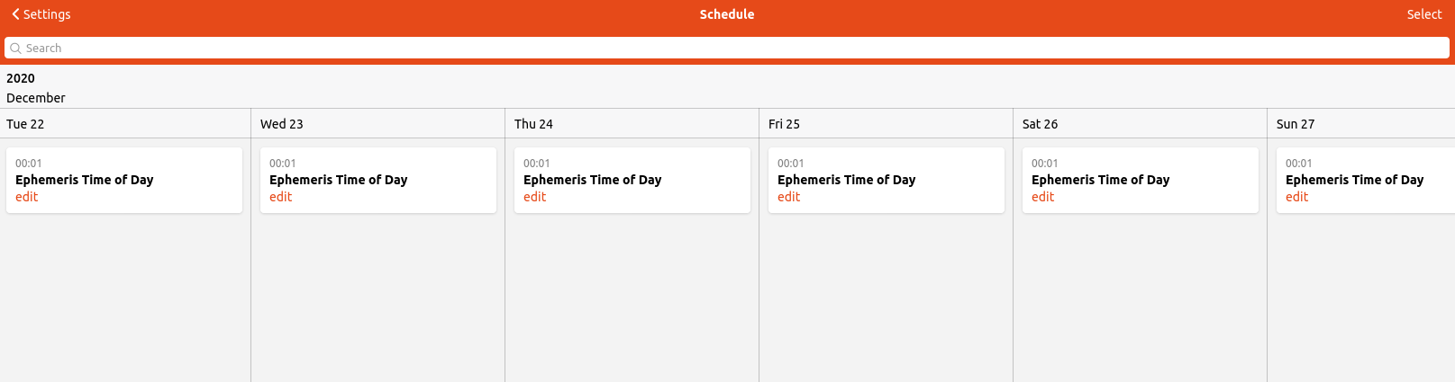

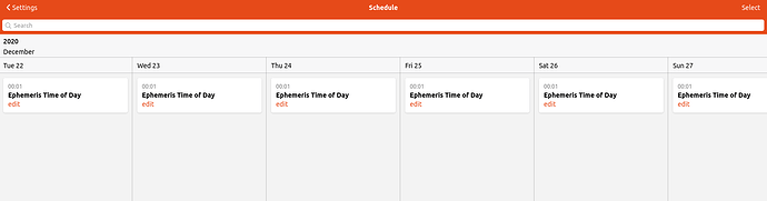

Once you have at least one Rule that is tagged with “Schedule”, the “Schedule” entry will show a calendar showing you when those Rules are scheduled to run.

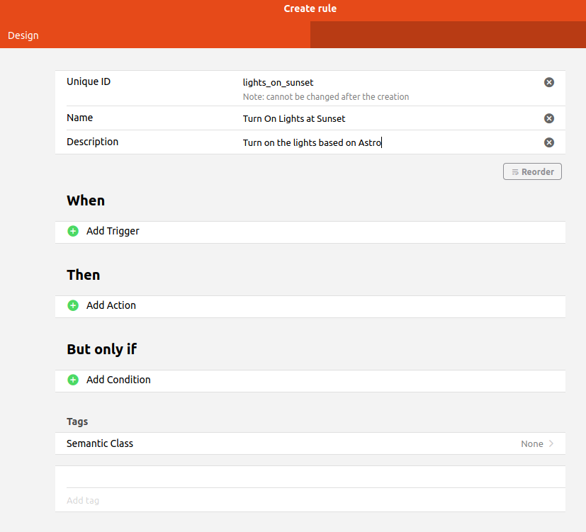

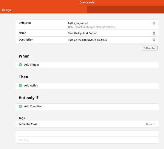

Add the Rule and fill in the ID and label stuff.

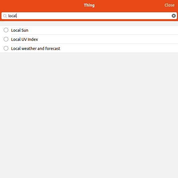

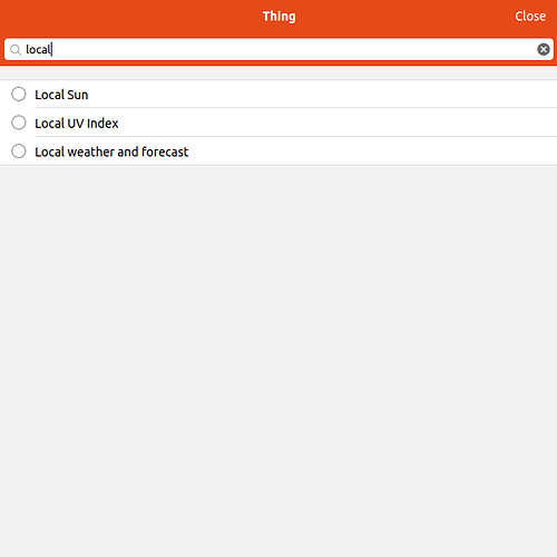

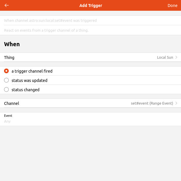

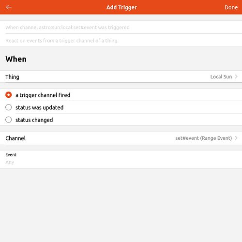

Add a trigger, choose Channel Trigger, and then choose your Astro Thing and the sunset#event channel.
Click “Done”.

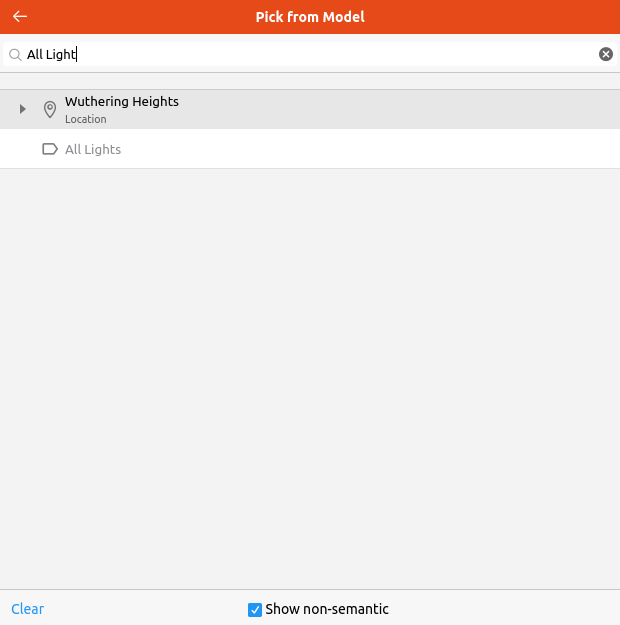

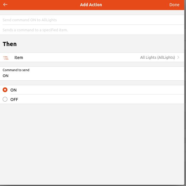

Now add an Action, choose Item Action, select your Item or search for it and clikc “Pick”.
Configure the command to send and click “Done”.
Click Save and you are done.

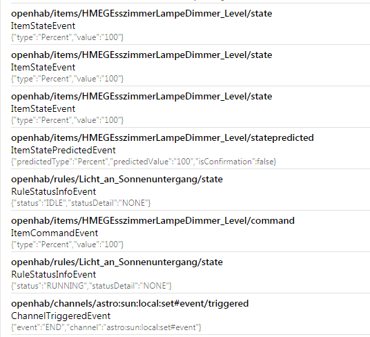

…and I am wondering, why I get multiple events in the developer sidebar.
Greetings, Timo

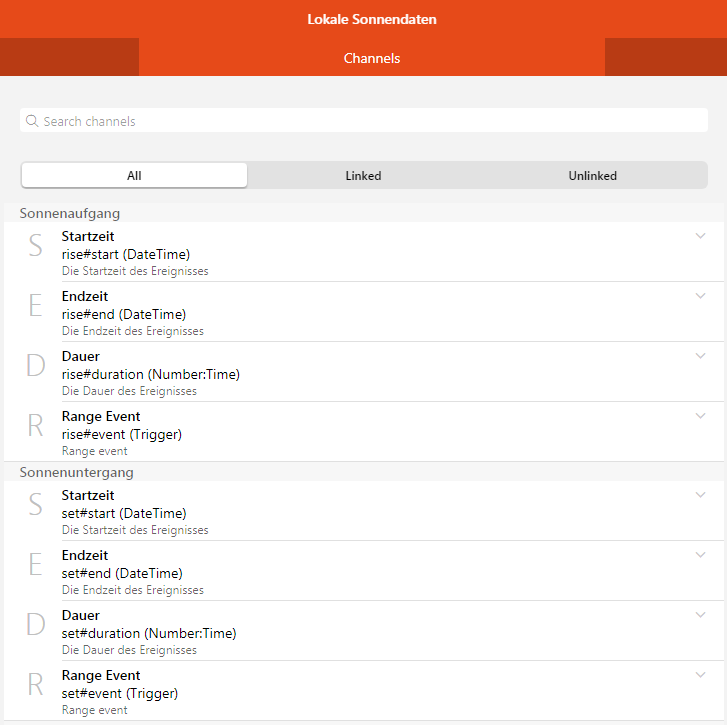

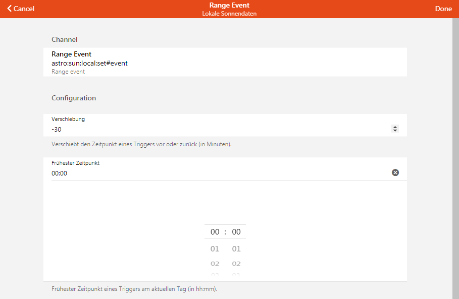

That’s well documented in the Astro binding docs. It’s a configuration parameter on the Thing’s Channel.
If you’ve had this before moving to OH 3, it’s all the same as it was. Astro has not changed.
Because what ever Thing/Binding that is linked to that Item is updating it more than once.
I believe you refer to this: Astro Binding - Channel config
But now it looks like this:
Do I need to go to the Code-Tab of this Thing?
Click on the channel you want to add the offset to and then select “Configure Channel”.
Don’t be afraid to click on things. It often becomes apparent how to do things when you just click on something or even hover your mouse over certain elements.
Excellent: :slight_smile:
