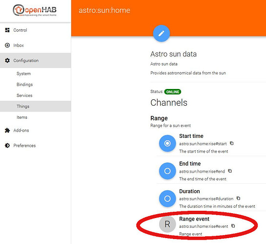

Haven’t found out yet how to do it with textual files …
To use the offset, you need the latest snapshot, in beta 5 there are only the events but not the delay included.
To configure a delay, you have to do this with PaperUI on the channel (click the pencil on the right)
But i also don’t know how to configure a channel config via config files. Maybe someone from the openHab experts can tell us.
@Kai any hint for us?
@sihui & @gerrieg :
Thank you! I do (and did) see that in the paper UI. Even so I don’t have an example on how to reference this event vs. the non offset events. Also having a predefined number (there are 13 ?) is probably not the way to go either as I don’t see that working for vast population that we all hope end up using openHAB. It could easily be a limitation of the UI as it stands currently and the devs trying to get something out there that we can use (or more probably I’m just not very smart) but it seems to be a limitation that will bite us sooner rather than later. In any case, thank you for the info. I might set something up with this once I learn more .. but I’m really hoping for some textual config. Perhaps Kai will have info along this line – or at least some alternative.
I did just find Defining Channels though and that may be more what I’m looking for.
