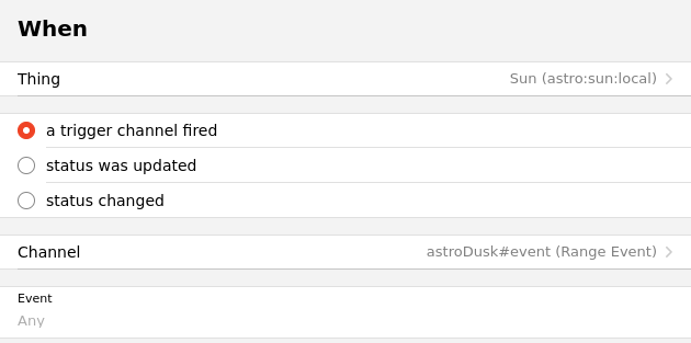

The first real problem is: the rule is triggered twice, whiche makes no sense to me, as astro.dusk should only fire once a day … For me it was yesterday at 8:15 pm (nautical twilight, which is wrong) and 9 pm (astronomical twilight, which is right). Is this a bug? Or do i miss something?

In the astro docs you will see that the trigger channels have multiple events:
Trigger Channels
Only these can be used in rule triggers as shown below. Note that they have their own offset configurations that are independent from offsets configured on the start or end times of e.g. the rise or set channels.
  • thing sun
  • group rise, set, noon, night, morningNight, astroDawn, nauticDawn, civilDawn, astroDusk, nauticDusk, civilDusk, eveningNight, daylight
    • event START, END
So without specifying which event you are interested in your rule will trigger at both the start and the end of given time period.
In the tigger configuration for the rule you need to add either START or END to the Event field:
As for the incorrect values, it’s been so long since I’ve used dsl, I can’t really help there other than to say are you sure that the item you’re using is not directional? The value would certainly drop if you’ve got negative values during the later parts of the day if this is a net consumption value and not a raw production value.
Another thing: Please be aware that W and Wh are somehow independent values, you can’t simply add power values and get energy, you’ll have to know the time factor. (pretty sure this is the 58… it’s very likely that it should be 60, then your power value would be the average power for one minute).
What kind of solar inverter do you use? Most of them do provide energy data as well as power data.
Thanks, this seems to be the point i was missing. The end of nautical dusk is the beginning of astronomical dusk.
Writing the rule i once added “start” as the event, but this lead to the rule never been triggered. Then i removed it, and indeed since then it was triggered twice. Yesterday i added “end” and in the eventing it was triggered once, as it should be.
So this one is solved :white_check_mark:
