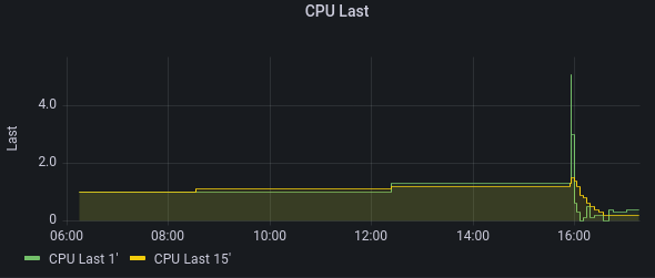

But while searching for the root cause, I have seen that the behaviour claimed in the original post was dependent of the uptime of OH.
I could see that not only the astro binding is affected but also others, like systeminfo and network and maybe others I haven’t identified so far.
It seems to me that the OH internal timers are getting mad. The actualization intervals are getting longer and longer. After the restart of OH it works fine again but it is again increasing.
The picture illustrates the long interval (4 days after last restart). After the restart it is fast again, but starts to increase.
I’m not sure when that started as I had many restarts the last weeks, but I assume it was with 3.3.0.M1.
