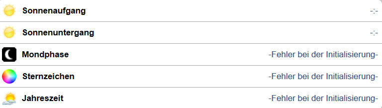

I have an issue with my astro items.
All the items don’t get status update a while ..

In case I restart the server/service or edit the file with the astro items, openHAB shows me on the webfront end the right information.
But after a while (3h or more) I get the following output.
But the binding must work in the background.
Because all rules which work with the astro events are working. I have no issue.
If I update the astro items, I get the following output in the log file:
