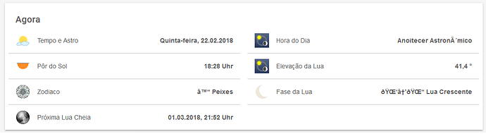

Hi all,
I tried to use an astro.map, but the simbols are not being displayed correctly.
My file is saved with UTF-8 encoding.
I translated the astro.map into Portuguese-Brazil (pt-br).

I was having the same issue. I am migrating from OH1 on Win to OH2 on Linux and transform maps do not work.
I made a script in subfolder which includes the original .map files. It converts them to the upper folder in Java friendly format.
LIST=`ls *.map -w 1`
for ITEM in $LIST
do
native2ascii -encoding UTF-8 $ITEM ../$ITEM
cat  ../$ITEM
echo ======================
done
Probably there is a way to specify UTF-8 as default in OpenHab2 and skip this step
