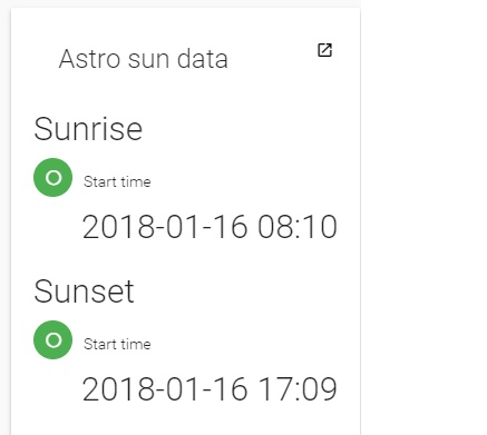

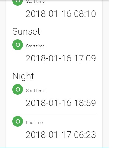

Not sure to understand values displayed with Sunset start. My Night start and Night end seems correct, Azimut and Elevation are also correct, but not Sunset start, no… see attached pict.
I don´t have “Start time” at the sunset-value. It´s only one timestamp.
In my case:
Sunrise: 08:30
Sunset: 16:50
Start of civil dusk: 16:50
End of civil dusk: 17:25

Why not? Check the times on https://www.suncalc.org/ for your specific location.
sorry this is the sunrise, not sunset, first on my pict showing 16:08, not possible, something wrong with that
I think there is a language misunderstanding?
sunset is when the sun goes down. So 17:09 or 16:08 can be ok.
sunrise is in the morning, when the sun goes up. And on your screenshot there is no line with sunrise, only sunset is shown.
So what is wrong? Can you post the complete screenshot of the astro-values?
Ok, I agree, I’m stupid, I was reading time with seconds… : 2018-01-16 08:10 So my small brain read 16:08:10 Maybe set more space between day and hour!
16 was the day
In the meantime I allready found it out by myself. Just RTFM :wink:
