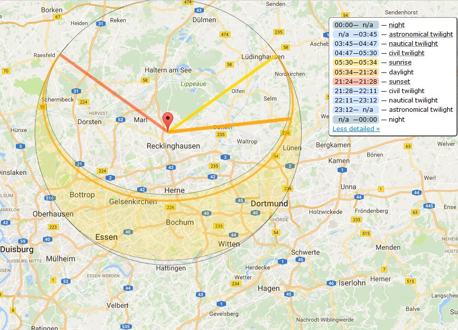

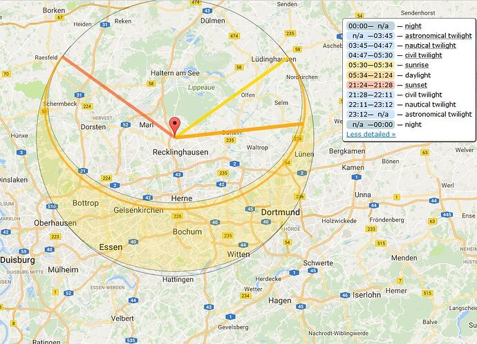

I am still running a version of the binding from before the move to the eclipse smarthome repository. The error seems to have been there all the time already.
Further to this, I also notice some of the channel triggers are missing. I only noticed the Nullpointer Exception when investigated one of my rules where the 'astro:sun:5d939aab:daylight#event' was not triggered while the 'astro:sun:5d939aab:rise#event' was.
Further analysis of the event logs shows the following over a 24h period with one defined sun thing:
2017-05-15 00:21:00.006 [ChannelTriggeredEvent ] - astro:sun:5d939aab:morningNight#event triggered START
2017-05-15 02:57:00.011 [ChannelTriggeredEvent ] - astro:sun:5d939aab:morningNight#event triggered END
2017-05-15 02:57:00.011 [ChannelTriggeredEvent ] - astro:sun:5d939aab:astroDawn#event triggered START
2017-05-15 04:17:00.006 [ChannelTriggeredEvent ] - astro:sun:5d939aab:astroDawn#event triggered END
2017-05-15 04:17:00.009 [ChannelTriggeredEvent ] - astro:sun:5d939aab:nauticDawn#event triggered START
2017-05-15 05:13:00.006 [ChannelTriggeredEvent ] - astro:sun:5d939aab:nauticDawn#event triggered END
2017-05-15 05:13:00.012 [ChannelTriggeredEvent ] - astro:sun:5d939aab:civilDawn#event triggered START
2017-05-15 05:54:00.007 [ChannelTriggeredEvent ] - astro:sun:5d939aab:rise#event triggered START
2017-05-15 05:54:00.011 [ChannelTriggeredEvent ] - astro:sun:5d939aab:civilDawn#event triggered END
2017-05-15 05:58:00.005 [ChannelTriggeredEvent ] - astro:sun:5d939aab:rise#event triggered END
2017-05-15 13:41:00.005 [ChannelTriggeredEvent ] - astro:sun:5d939aab:noon#event triggered START
2017-05-15 13:42:00.005 [ChannelTriggeredEvent ] - astro:sun:5d939aab:noon#event triggered END
2017-05-15 21:24:00.003 [ChannelTriggeredEvent ] - astro:sun:5d939aab:set#event triggered START
2017-05-15 21:28:00.006 [ChannelTriggeredEvent ] - astro:sun:5d939aab:set#event triggered END
2017-05-15 21:28:00.010 [ChannelTriggeredEvent ] - astro:sun:5d939aab:civilDusk#event triggered START
2017-05-15 22:09:00.008 [ChannelTriggeredEvent ] - astro:sun:5d939aab:civilDusk#event triggered END
2017-05-15 22:09:00.010 [ChannelTriggeredEvent ] - astro:sun:5d939aab:nauticDusk#event triggered START
2017-05-15 23:04:00.006 [ChannelTriggeredEvent ] - astro:sun:5d939aab:astroDusk#event triggered START
2017-05-15 23:04:00.006 [ChannelTriggeredEvent ] - astro:sun:5d939aab:nauticDusk#event triggered END
I believe this should also contain events for: astroDusk END, night, eveningNight and daylight. Or am I missing something?

The problem is, that the astro-binding has moved to the esh-repo and it look like that the binding is is not rebuilded with the the last snapshots. It is still on version 201700512.
The real problem is that in lower latitudes it is not possible to calculate dark-night and astro-dusk. A workaround is to lower the latitude to values lower then 50 … I set my latitude in the Monent to 45 and than all values can be calculated and the NPE has gone. That is only a workaround since the fix is moved to the snapshot.
You can look at : http://suncalc.net
Here you can see, if you lower the latitude how the values move to n/a if you go right to north
Yepp, now I see:
Moving my house from the northern part of Germany to the northern part of Italy did the trick :sob:
So let’s wait for the fix make it into the binding …
