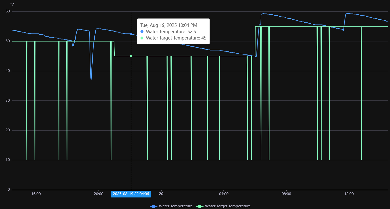

Hey @ArdKuijpers, trust you are fine. Since one of the latest updates, I see some weird spikes in the graph. Just wondering if you have a clue where they come from. I can confirm that the target water temp does not drop to 10.

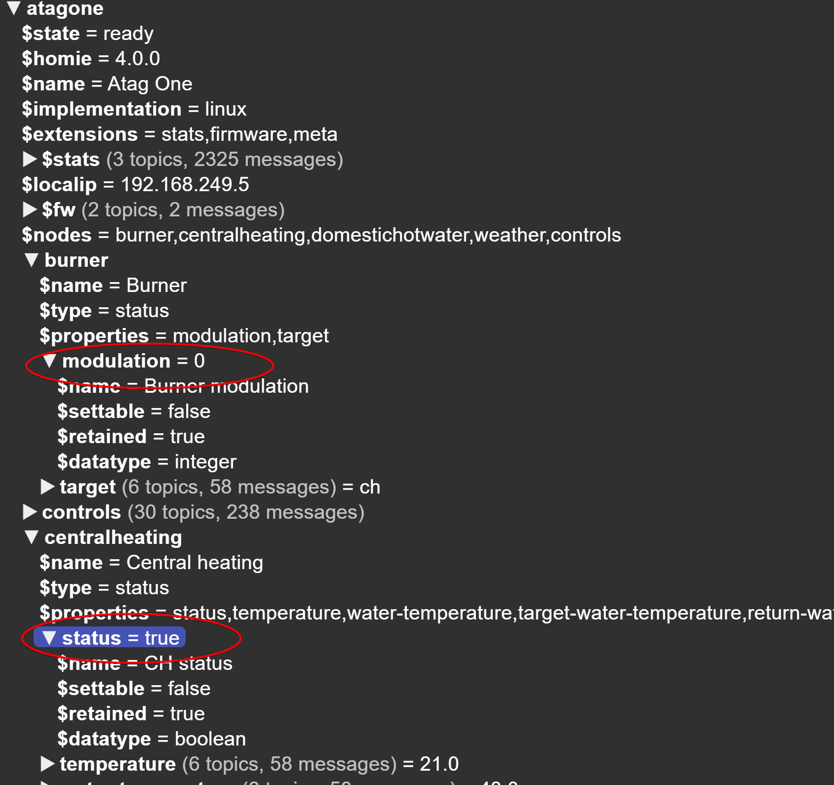

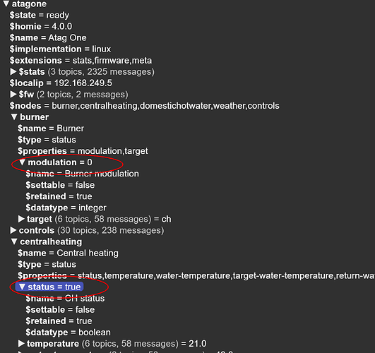

Could someone post a screenshot of what their Atag MQTT thing looks like please? I’ve looked at the code of the atagone2mqtt app and it looks like it provides the channels I’m interested in but I can’t tell whether the flame value is an on/off (the boiler is flame is on or it’s not) or it’s a modulation percentage, i.e. the boiler is producing heat at x% of its total capacity.
I’d like to implement weather compensation for the central heating so I’d like to be able to set the CH water setpoint and the DHW setpoint and also view the CH return temperature and the burner power.
Here is a screenshot from my MQTT Explorer where you see the topics …/burner/modulation and …/centralheating/status:
The burner/modulation is an integer that should reflect the % (integer betwen 0-100) of the burner capacity that is currently used. The centralheating/status is a boolean that reflects whether the burner is currently being used for the central heating.

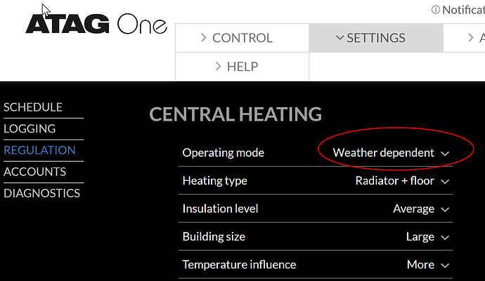

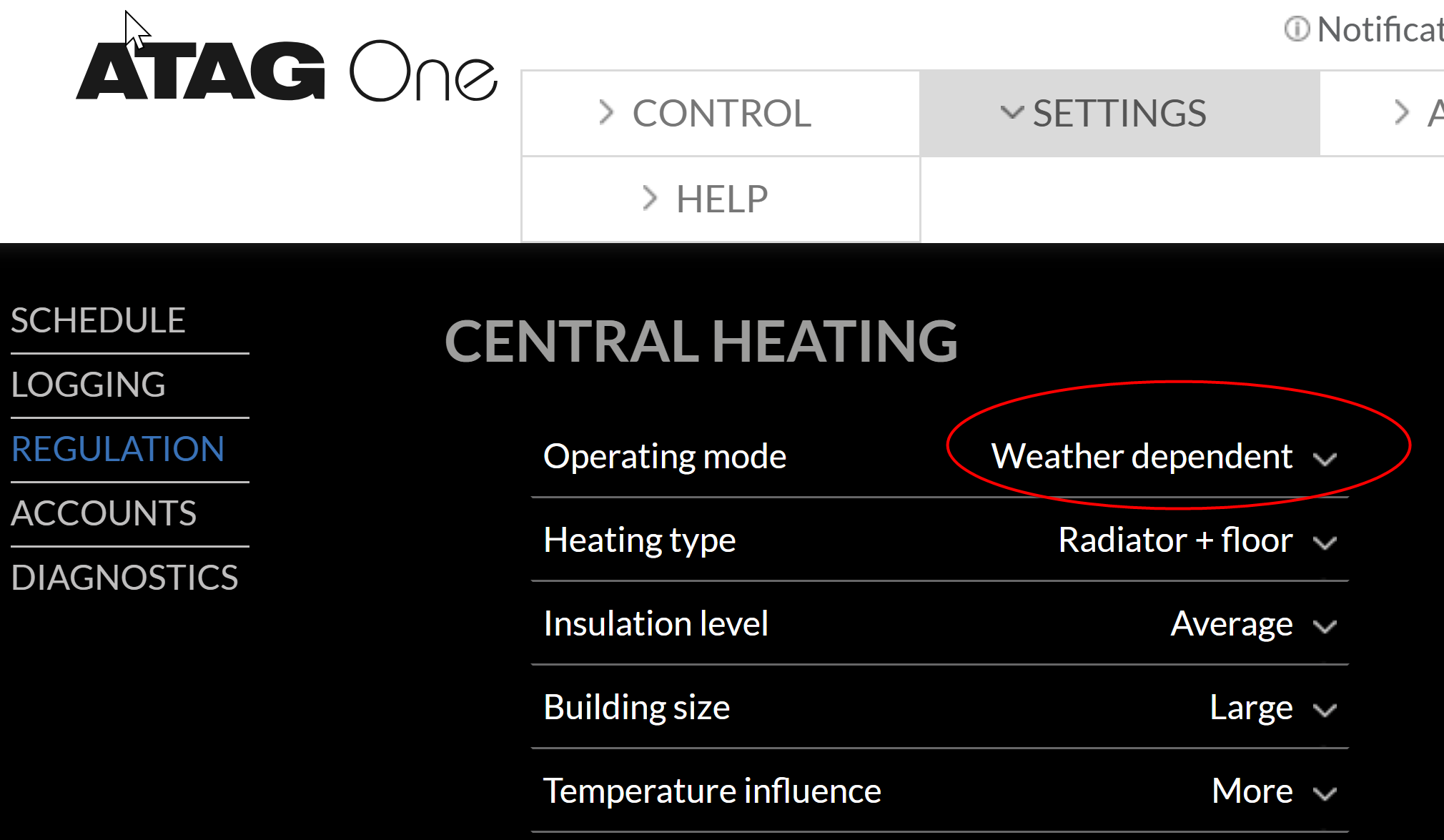

You say you are trying to implement weather compensation, but as I understand, the AtagOne thermostat can/does already do that if you configure Operating mode: Weather dependent in the Atag One portal/app:
