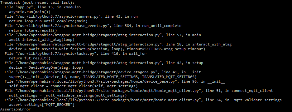

sorry for asking stupid questions. I managed to fix the python issue by updating to 3.8. The script now detects the ATAG one on my Pie, authorization seems to work as well, but when the script tries to create the Homie device, I get an exception
The assertion error is from the homie library. It looks like the settings['MQTT_BROKER'] variable is empty. If you set the MQTT_HOST environment variable, it will be used to set the settings['MQTT_BROKER'] for the library. This works well for Docker images.
If you do not want to work with environment variables, you can also generate a .env file (copy if from .env.sample) and set the MQTT_HOST there.
