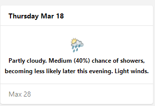

This is something I have been struggling with for the past week or two but have FINALLY managed to get it to work and if anyone else wants to use it look at it etc feel free.
It is a NO FRILLS weather forecast program that gets the data from the Australian BOM (Bureau of Meteorology) in json format and puts the downloaded data into an item call BOMdata (called that only so you can copy and paste code without changing things)
There is a BOM addon for openhab that has been created already and it is very good and if you need all the bells and whistles then use that but it creates nearly 100 items, If you just want basic 7 day forecast and forecast temperatures and only want to add one item then this is for you.
It is my first attempt at doing something like this and also my fiest attempt to publish something like this on github, but here goes.
What is looks like etc is here:
Pages · ubeaut/openhab3-BOM-program Wiki · GitHub.
