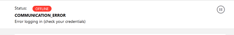

I was using Somfy binding for past few months without an issue to control shutters. SInce past week it is not longer working. I see in OpenHab that there is an error in bridge with “Authentication challenge”.
I have tried to reset password and found a strange thing. I can log into Tahoma using Android app and Somfy Connect but if I am trying to log in through TaHoma® I am always getting an error that password is incorrect.

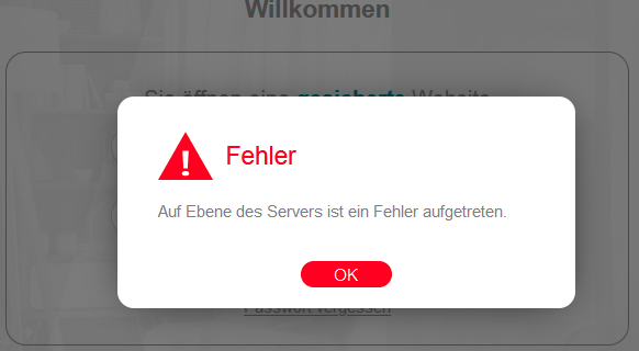

I am having the same issue since last Tuesday. I have an somfy Connexxoon. I contacted Somfy support, but they were not very helpful. They just stated that the Connexxoon can only be controlled via the Connexxoon phone app. I can login in the connexxoon app and the somfy connect website. The tahoma website doesn’t work for me either. I can log in, but then shows me ‘An error has occured on the server’. When I purposely use a wrong password it shows me the wrong password error. So I don’t know what that first error message means.

the website has an error:
binding uses www.tahomalink.com to login.

this night I disabled the Binding and enabled it again in the morning. The break seems to help, it is working again. Probably that break helps the somfy side to reset…
I disabled for 30-45 minutes and it seemed to do the trick, good spot (may need to wait longer if that doesn’t work for people).
I think I had seen a mention before (probably in your link agove) somewhere about the authentication hitting a rate limit and just giving the bad credentials error still, rather than anything more useful.

Disable for some time and enable it fixes the problem fir me too.

The reason for the authentication issue is that the user account is blocked.
If have asked for a log file on WHY this happens but haven’t received one.
I assume the amount of calls to the api was restricted and the default setting in the binding is 30 seconds.
Which calculates as 2880 times a day. Has anyone played with this setting in order to achieve a working binding?
