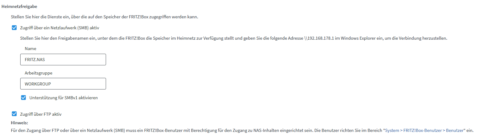

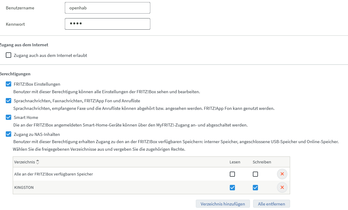

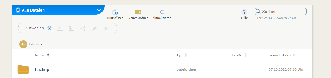

I need help with the MOUNT problem anyway, can help somebody
Nas in browser logged in with openhab user:
CIFS Support ist installed
