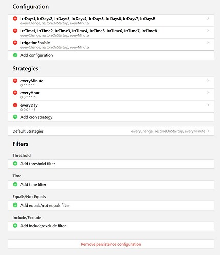

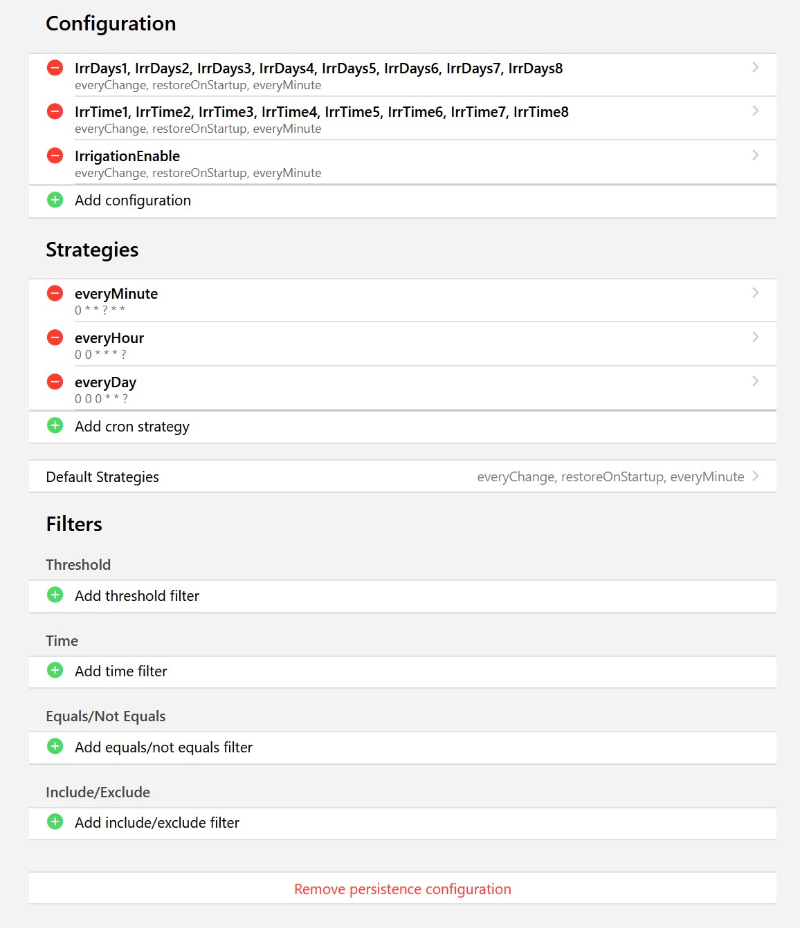

Thank you for the reply. I did have mapDB persistence set up for the irrigation variables with restoreOnStartup. I have added every minute as you suggest, but the values are still not restored after the power fail. This the configuration in the UI. Is there any other global setting that I need to make this work?
Mapdb Persistance
