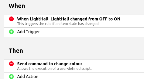

I have something similar but I only use 3 colours and different brightness levels.
I use a Hue motion sensor to send an ON command to the HSB light bulb if the lux level is less than 4.
The astro binding is used to determine the phase of day. If it is daylight then the light will be green and 100% brightness. If the phase of the day is night then the light will be red and 50% brightness so you don’t get blinded in the middle of the night :slight_smile:
If the phase of the day if not daylight or night (dusk, dawn etc) then the light is blue and 75% brightness.
The programming is done using the UI and javascript. (no DSL)
It is basic but works well.
//If daylight the light will be 100% bright and green. If night it will be 50%bright and red
//Any other day phase it will be 75% and blue
// logger.info("About to test executeCommandLine");
var Exec = Java.type("org.openhab.core.model.script.actions.Exec");
var Duration = Java.type("java.time.Duration");
//if it is not NIGHT then change colour
if (itemRegistry.getItem("LocalSun_SunPhaseName").getState() == 'NIGHT' ) {
//HSB Hue,Saturation, Brightness Below is 50% bright
events.sendCommand("LightHall_Lighthallcolour", "350,99,50"); //red
} else if (itemRegistry.getItem("LocalSun_SunPhaseName").getState() == 'DAYLIGHT' ) {
events.sendCommand("LightHall_Lighthallcolour", "100,99,100"); //green
}else{
//it is not NIGHT so only do green light
events.sendCommand("LightHall_Lighthallcolour", "225,99,75"); //blue
logger.info("hall light = " + itemRegistry.getItem("LocalSun_SunPhaseName").getState() );
I could have integrated the motion and the on rules but I kept them separate because sometimes I want to turn all the lights on regardless of light levels. I have and all light group switch for that.
