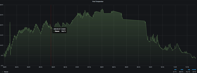

I’m also controlling my pool pump runtime with tasmota, but based on the temperature of the water. the purpose for this is just to save energy and I do not have any kind of water heating.
the tasmota flashed sonoff I use to switch pump and lights is just at the edge of my wifi router and often loosing the connection followed by reboots which also resets the “PulseTime”. So, to get a maximum of reliability I created three tasmota-rules which power ON/OFF the pump at specific times. openhab just reads the temperature and selects tasmota-rules by issuing MQTT actions. by this, my pool should survive a multi-week openhab outage.
my future task: tasmota rules are IF THEN ELSE capable since some time, so I could completely trigger the pool runtime within tasmota. => winter-project :slight_smile:

I use a Sonoff Dual to control the pump on one relay and poollights with the other. I attached a DS18B20 to on of the free GPIOs and attached the sensor on the outside of my pool, adding a thick layer of styrofoam to isolate against air temperature
