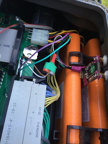

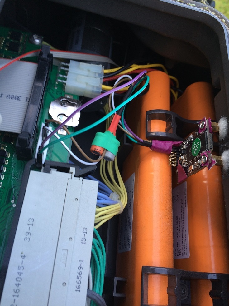

I want attach the binding I made. But I was not able to upload a .jar-File. Can anyone help me? As I know, it will just work with the G2 models (ACX 220, 230..) from Husquarna.
To connect the Automower to Openhab, you need a Wlan to Serial Adapter (see pictures of my Adapter). I ordered it from direktly from china - for about 30 EUR. A german discription can be found at
or just google “Wlan Automower G2”.

Here is a Picture of my WLan to Serial Adapter

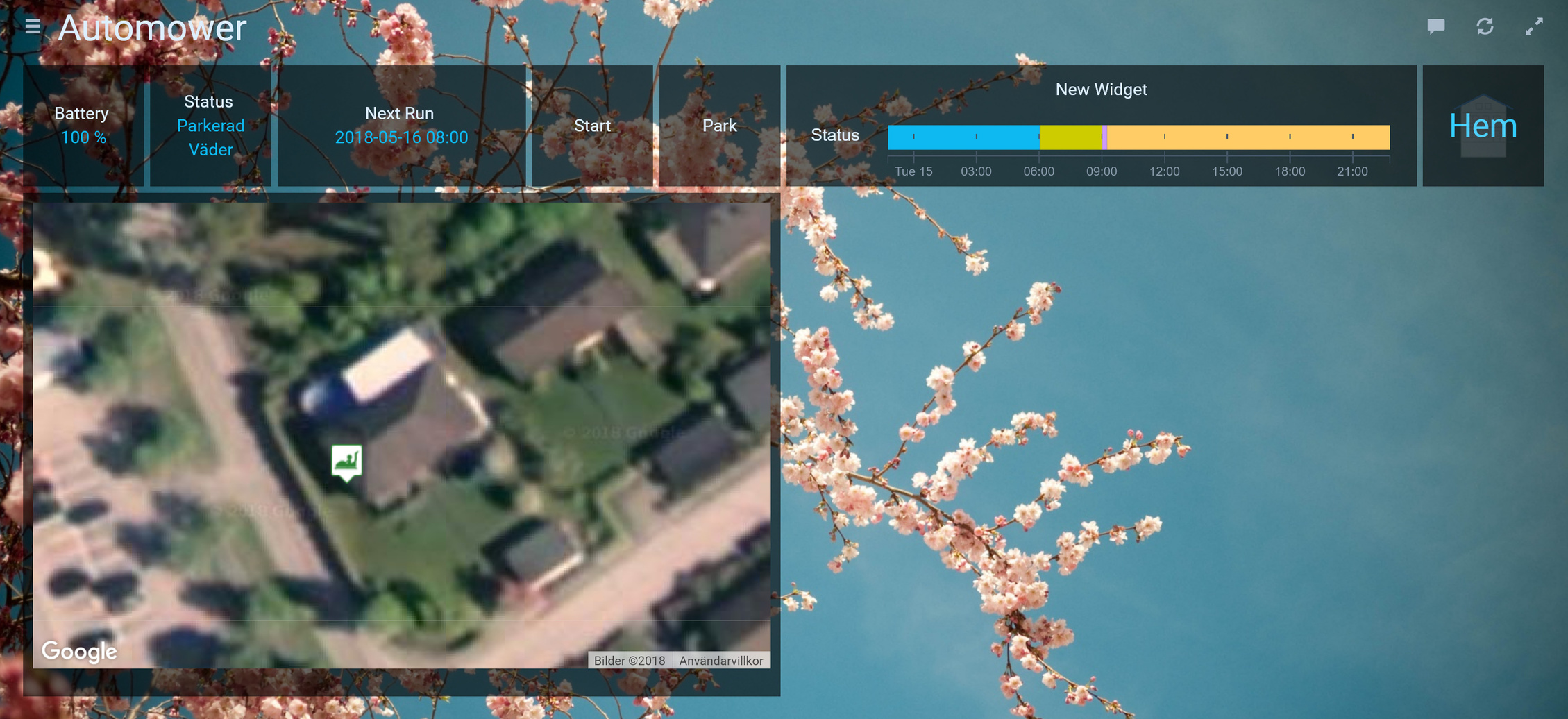

I am also interested in a Automower Connect binding. Now i have integrated Automower Connect with https://github.com/chrisz/pyhusmow
Example how my Automower looks in habpanel.
