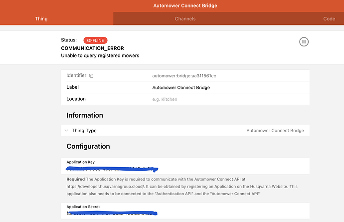

Does this binding still work?
I Got a key and secret on the Husqvarna website but i get an error
Any idea?
Hi @jpcolin,
the binding does work for me. Can you share some logs?
Best, Lui
Same here, works fine. Did you try refreshing/renewing the keys?
I tried, same error.

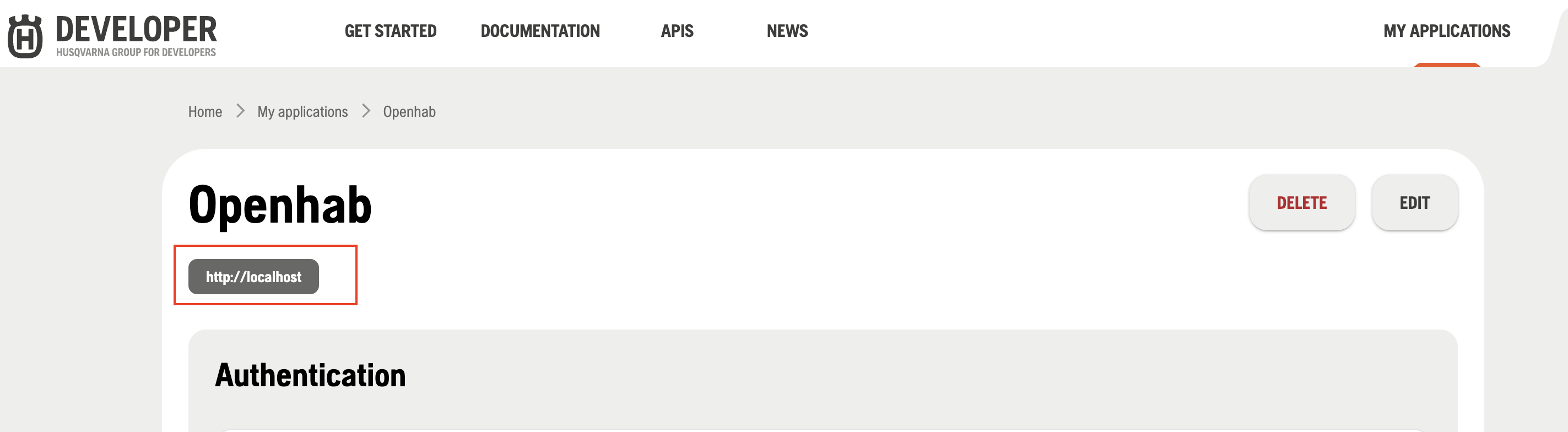

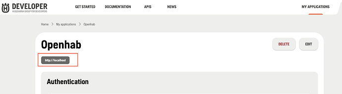

Is this correct the http://localhost?
