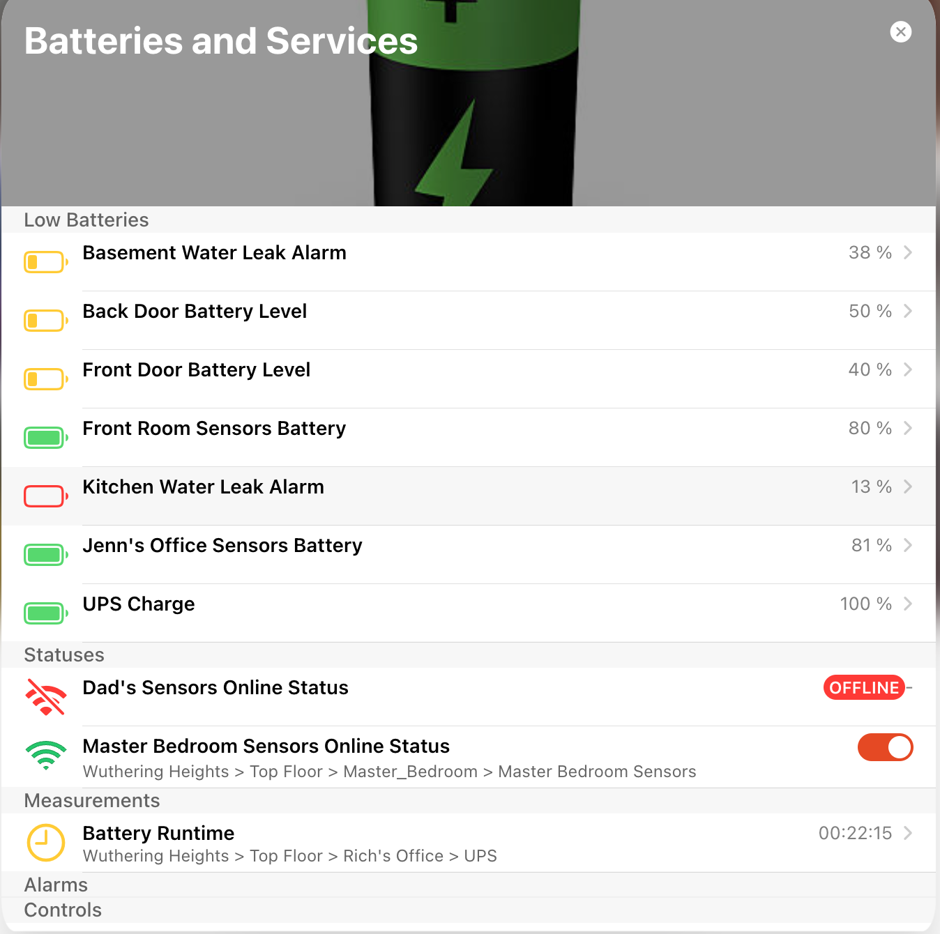

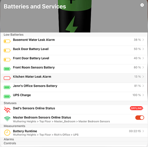

I have the same use case. There really isn’t a great combo of tags that exist right now for this. I use “Status” for the Point and “Power” for the Property.
Furthermore, I set the custom list item widget and set the visibility to only be true when the Switch is OFF so it only shows up when there’s a problem.
On the Properties tab, I customized the card for Power to read “Batteries and Services”.
They show up under “Statuses”.
Hmm, I need to go configure that Master Bedroom Sensors properly.
Also note, these Items are part of the equipment being measured. So, for example, I have a Dad’s Sensors Equipment which is made up of Items from Network binding and others.
