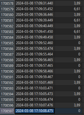

Thats also what I thought, which is why I tested with now.minusMinutes(5) as the duration while keeping the persistence to “every change”, which is every couple of seconds. I’ll give you an excerpt of the persistence database of the raw data item:

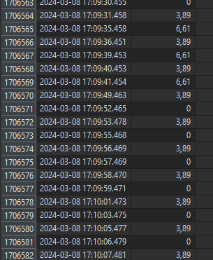

as you can see, there are multiple values lasting for a couple of seconds, while the averages-item just mirrors the same value without calculating an average:
as you can see, even though I requested a historic state 30min earlier, the state that gets returned is the most current one.
The database itself is full of values every 15s.
It’s hard to tell because you’ve truncated the timestamps of the log statements but the log is occurring at 12:08 but the timestamp on the historic state is 10:08. When persistence looks for an entry, if there is none in the timeframe you’ve specified, it assumes the Item hasn’t changed since the most recent update which, according to this timestamp, was two hours ago.
All I can recommend is to check your timezone settings on OH, the OS and the database.
Yes, that was the problem! The DB is running on a different VM which was set to UTC, while openhab was set to Europe/Vienna (GMT+2 atm) in openhab and OS.
Now it is averaging as expected.
