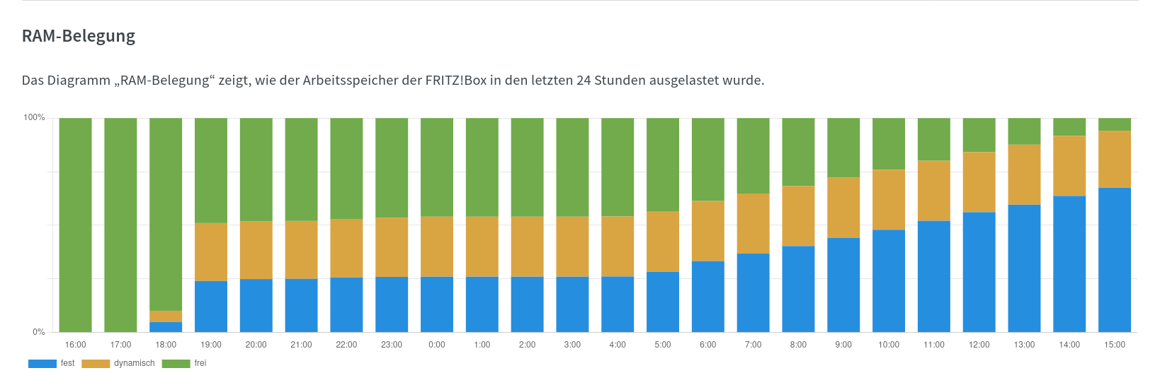

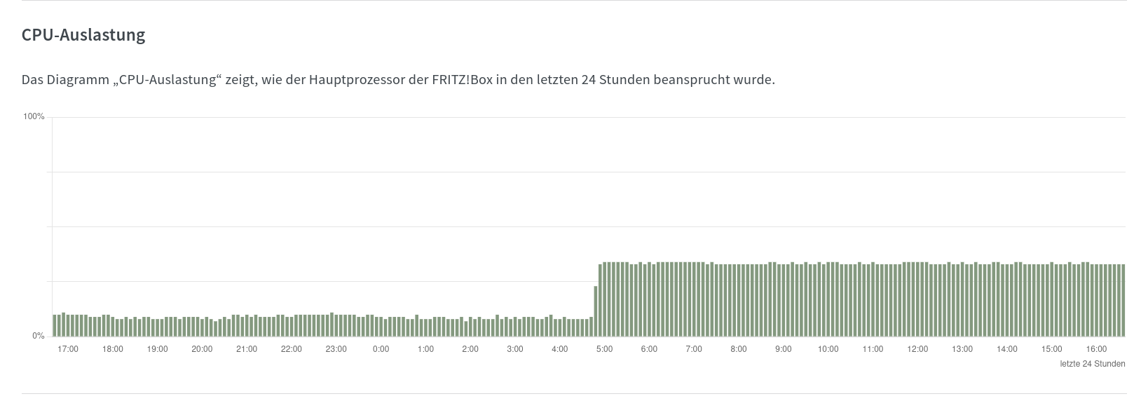

2025-12-27 16:35:16.377 [DEBUG] [nal.hardware.FritzAhaContentExchange] - GET response complete: null
In the FritzBox itself – in my case a 7590 with firmware 8.20 – you can see in the statistics page that the CPU load increases from approx. 10% to 30% and more after a longer period of time.
The RAM usage also increases steadily.
However, the increase in usage only occurs several hours after the binding has been terminated.
If I deactivate the binding in openHAB, the load in the FritzBox no longer decreases.
In this case, I have to restart the box.
If I don’t restart the box myself, it crashes and automatically restarts.

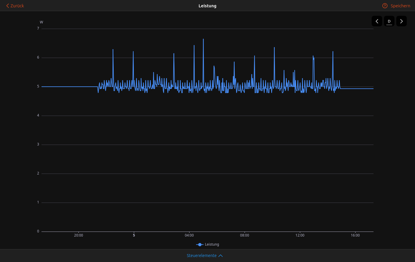

UPDATE: I have no idea whether we have an openHAB problem here or whether we are triggering a bug in the FritzBox firmware that causes the RAM to overflow.
Quick update: Even reinstalling the binding doesn’t help.
After a few hours, nothing works again.
Flat line = dead :sweat_smile:
