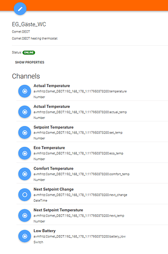

Hi Christoph,
I’m quite not sure if that’s what you asking for. This is a screenshot showing the active channels of the comet dect defined via paper UI.
Down below there is the rule from node red where i tried quite simple to inject manually two different setpoint to the comet.
