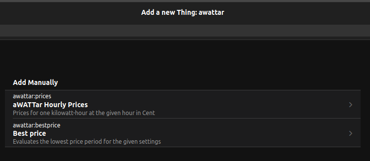

I am new to openhab and would like to use the awattar binding but looks like I am missing something about “creating the bridge thing”. I have created a thing with the awattar binding - which is “offline” - and clicking on bridge opens a section with a radio button and nothing else.
Any help is appreciated. Thank you!
kr,
Martin

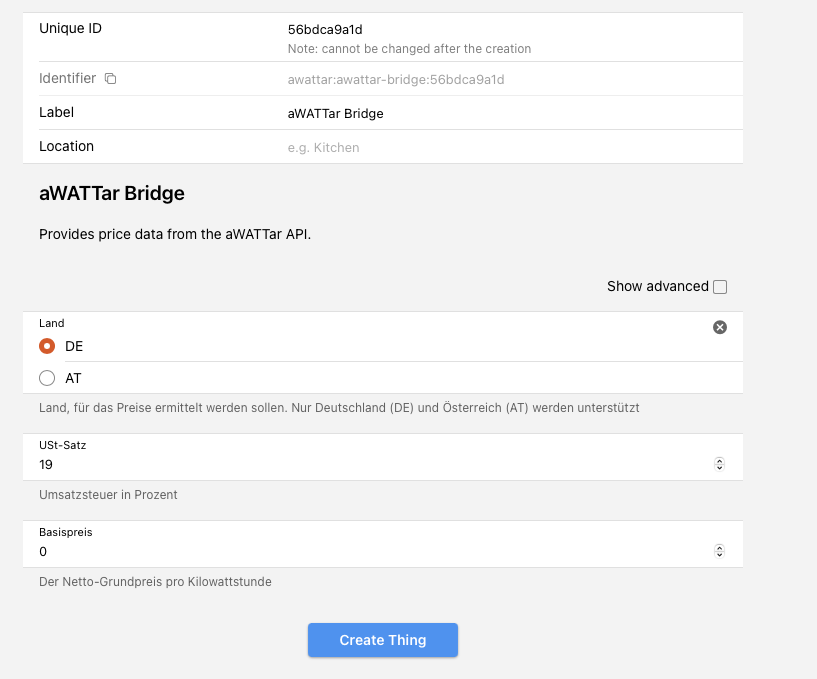

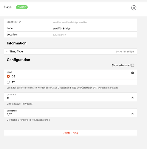

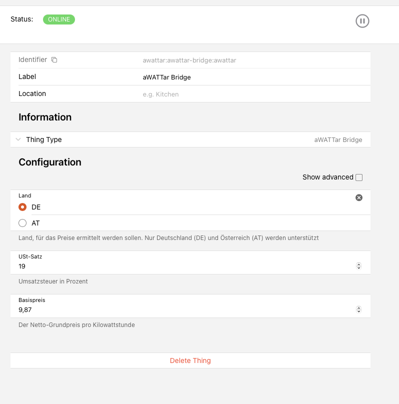

Hi Martin,
the bridge needs to know whether you need the prices for DE or AT.
For me it looks like this in the openHAB GUI:

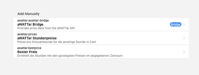

If I try to add a new thing manually, I see this:
and clicking on aWATTar bridge this:
How does it look like in your browser?

What could be the reason for not having the bridge item displayed at all?

I use openHAB 3.4.M2 and I can not add the bridge with the UI (same as @martingwb reports). I have to add it in a file: openhab/conf/things/awattar.things as per the documentation.

In my home installation I configured it using the GUI, and it is displayed correctly. During development I most of the time used config files for testing.
I updated to openHAB 3.3 now and it still displays the bridge correctly
