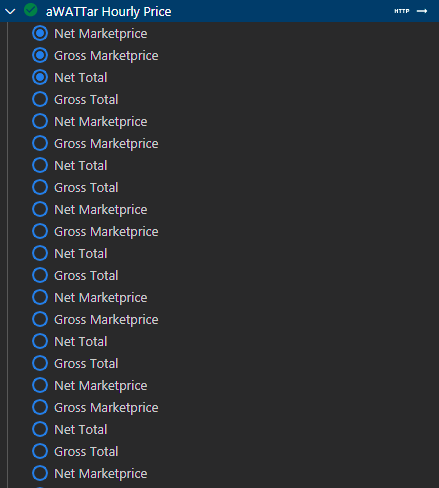

Also strange behavior in VS Code:
Hi @tailor09 , added the possibility to choose a country in the bridge definition. Did not yet look at the VS Code issue. To me it looks like VS Code shows only the channel labels, but not the labels of the surrounding channel groups, so you get the same four channels. 49 times.
We may open a discussion here: Is it helpful to deliver the four prices for every hour or would you prefer to only get the net market price and calculate the others in a rule or script according to your needs? If you opt for the 2nd version I am fine with that and remove the groups.
