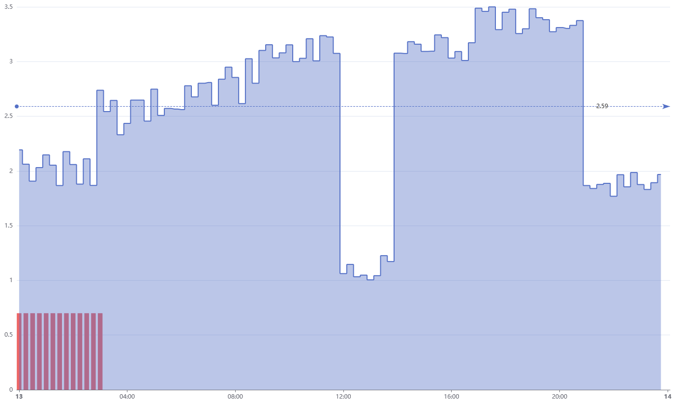

  • the user would not have to interact with any code snippets like in my current openHAB Spot Price Optimizer, all input arguments could be provided as parameters via the UI when creating the Rule
  • the result would be a real timeseries i.e. it can be rendered using Charts along with other timeseries (e.g. spot prices, weather forecasts) like in the screenshot below. Blue area represents the price of the electricity and the red bars represent the time when the boiler would be allowed to be ON.
