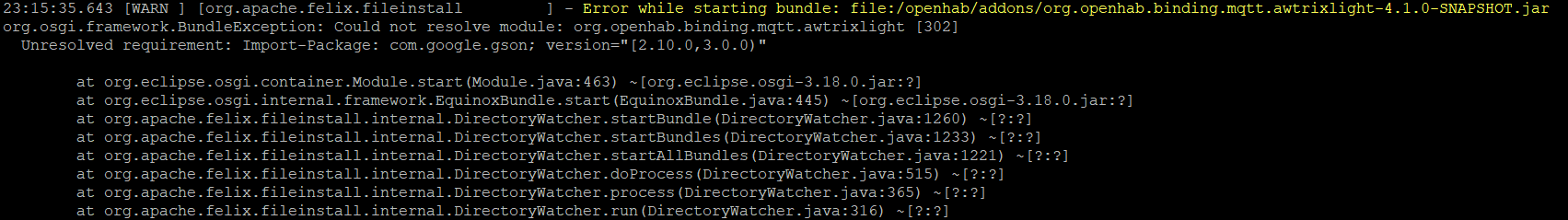

Ok, I reup my OH 4.0.3 container.
In this version, I get an installed after bundle:status org.openhab.binding.mqtt.awtrixlight
but :frowning:
I get also this
and
So it is installed but doesn’t work.
With OH 4.1.0 I dont get the installed message or the error.
In 4.1.0 there is nothing …
hope this helps :pray:
The latest binding builds will only work on 4.1.0 and up due to a missing gson dependency in older versions. So the error on 4.0.3 is expected. However it should install also in the 4.1.0 version and it sure does in mine.
