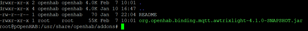

Install via Marketplace still fails but even manual install (by putting the *.jar in /usr/share/openhab/addons) doesn’t do the trick.
I have the light up and running and I am eager to get it openhab’d
Could you describe in detail what happens when you drop the file? Have you set proper permissions on the jar file? Do you have anything in the logs?
When I drop the file, nothing happens.
My OH logs are empty.
The current permissions are
Changing it to openhab:openhab didn’t make a difference.
Any ideas what I’m doing wrong ?
you can try to move the file to a different location and change the file ownership:
chown openhab:openhab NAMEOFJARFILE
Then move the file back into the addon folder. I hope this fixes your problem.
EDIT: sorry I saw that you already did that. portboy reported a similar problem a few posts earlier but somehow solved this. Maybe his approach could help you too?
One other thing: have you touched the file after changing the ownership? I would try that first
