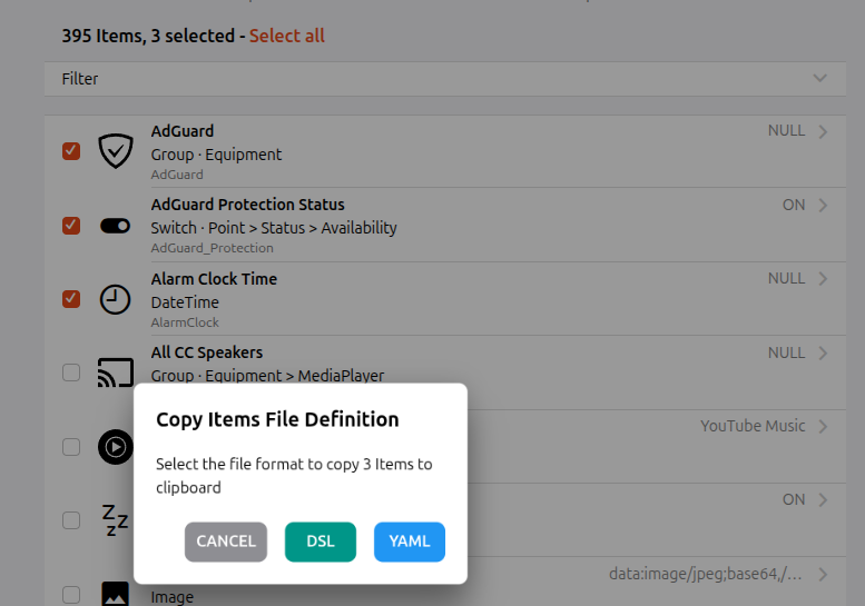

It is already there in place for items and things.

  3. There already is a very strong focus on file-based configuration. We have a new YAML format that lets you define everything and supports stuff not supported in any other file format, such as rule templates and simple UI rules (eventually I would expect this file format to support everything). A new translation service was added to the API awhile back which can convert from one format (e.g. .items files) to another (e.g. yaml) and it can be used to export a managed config to either format.
Group AdGuard "AdGuard" <if:cib:adguard> (Wuthering_Heights) [Equipment]
Switch AdGuard_Protection "AdGuard Protection Status" <material:toggle_on> (AdGuard) [Availability, Status] { channel="http:url:adguard:protection_status", autoupdate="false", expire="1h0m0s,command=ON", listWidget=" " [icon="=(@@\'AdGuard_Protection\' == \"ON\") ? \"if:cib:adguard\" : \"if:simple-icons:adguard\"", iconColor="=(@@\'AdGuard_Protection\' == \"ON\") ? \"green\" : \"red\""],
matter="OnOffPlugInUnit" [label="AdGuard"], widget=" " [title="AdGuard Blocking"] }
DateTime AlarmClock "Alarm Clock Time" <f7:clock> { listWidget="widget:rlk_datetime_list" [inputmode="datetime-local", label="Alarm Clock Time", name="alarmtime", outline=true, placeholder="mm/dd/yyy, --:-- --", sendButton=true, subtitle="=items[\"AlarmClock\"].state", title="Alarm Clock Time", type="text"], widget="widget:rlk_datetime_standalone" [label="Alarm Clock Time"] }
version: 1
items:
  AdGuard:
    type: Group
    label: AdGuard
    icon: if:cib:adguard
    groups:
      - Wuthering_Heights
    tags:
      - Equipment
  AdGuard_Protection:
    type: Switch
    label: AdGuard Protection Status
    icon: material:toggle_on
    autoupdate: false
    groups:
      - AdGuard
    tags:
      - Availability
      - Status
    channel: http:url:adguard:protection_status
    metadata:
      expire:
        value: "1h0m0s,command=ON"
      listWidget:
        value: ' '
          icon: "=(@@'AdGuard_Protection' == \"ON\") ? \"if:cib:adguard\" : \"if:simple-icons:adguard\""
          iconColor: "=(@@'AdGuard_Protection' == \"ON\") ? \"green\" : \"red\""
      matter:
        value: OnOffPlugInUnit
          label: AdGuard
      widget:
        value: ' '
          title: AdGuard Blocking
  AlarmClock:
    type: DateTime
    label: Alarm Clock Time
    icon: f7:clock
    metadata:
      listWidget:
        value: widget:rlk_datetime_list
          inputmode: datetime-local
          outline: true
          placeholder: "mm/dd/yyy, --:-- --"
          sendButton: true
          subtitle: "=items[\"AlarmClock\"].state"
          title: Alarm Clock Time
          type: text
      widget:
        value: widget:rlk_datetime_standalone
