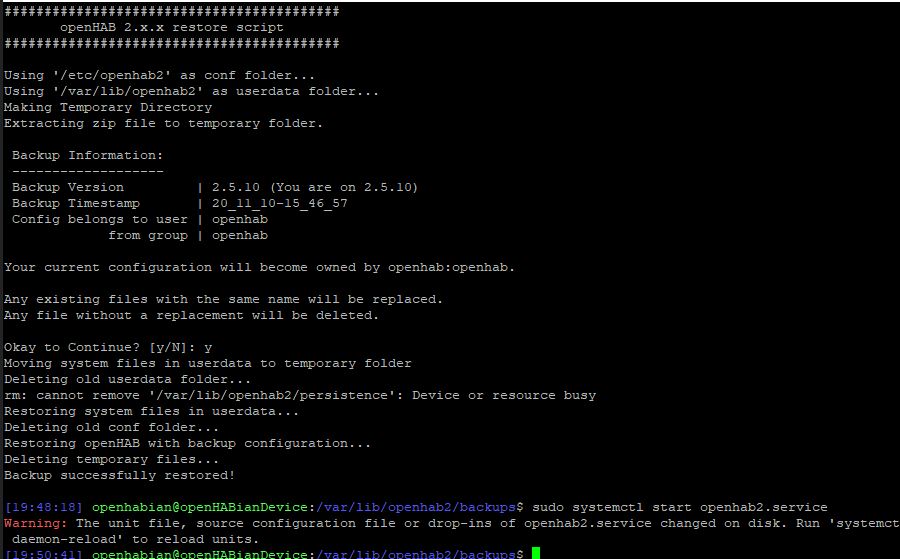

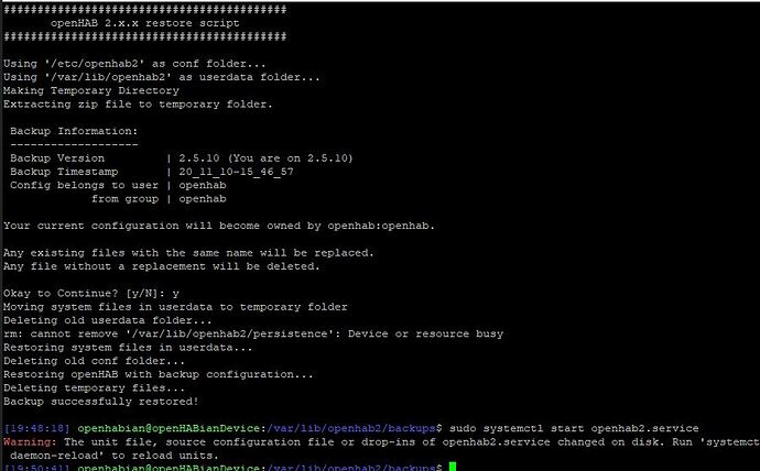

My secound idea was, to install a new fresh image from OH2.5.10 on a SDcard and work with a backup and restore zip file from the “old” HW
I so installed a new image, added all bindings etc, and have restore the backup from the zip file.

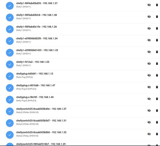

This is also without success, beause a lot of thing have bin found now as new things. So all my rules will not more work because the default name is different with original things name.
Im using shelly things and TP-Link thinngs, Hue, samsung and LG.
The new things I see only from shelly and TP-Link.
