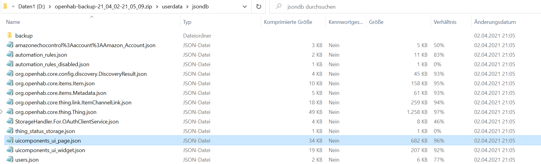

So I’m at a loss now. Looks like my backup file is messed up? The resources I have on my computers:
- an image of my RasPi just before I rebooted everything. Probably not worth much.
- Two backup-files which didn’t work when I tried to do a backup. The later one looks like this:
- Once I just copied the files from the SD-card (not using the backup function), seems rather worthless, looks like this.
So, what could be the problem, what are my options?
- Are both backup files broken or might I have done something wrong (used the backup/restore function of the openhabian configuration tool)?
- If the files are broken, at least some of its data might be helpful. Can I copy them manually? If so, which files/folders should I copy to which location? Any better ideas before I go down that road?
