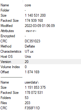

Backup size 170mb, userdata/core most of it
Hi
What is userdata/core ?

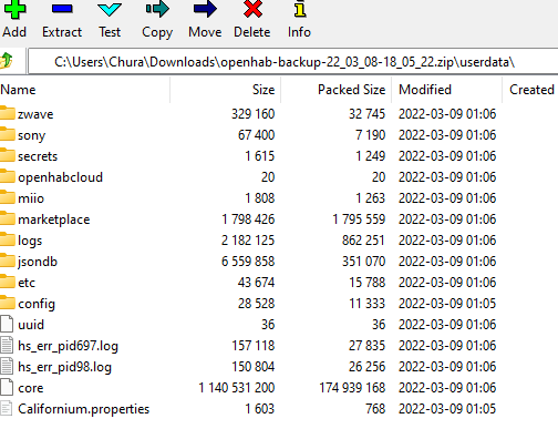

Mybackup’s are 178mb big, and most of the size is coming from that file
In the same directory next to this file you find directories like cache, etc, jsdondb ? Is that correct ?
Then I assume that the core file is a core dump.

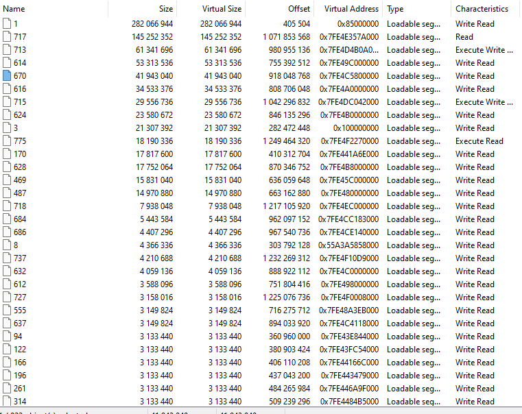

Not that I can see
Inside core file
Well, you was right
@daled:/openhab/userdata# cat hs_err_pid697.log | grep core
Core dump will be written. Default location: /openhab/userdata/core
