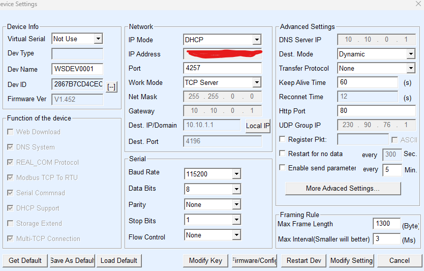

Configuration was straightforward

The link for python scripts is included in first post. The waveshare unit is an ethernet to rs485 converter so one set ip adrrss of waveshare device in the pyton script. If you can set static ip on waveshare device.
