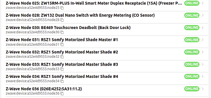

I recently bought some Bali ZWave roller blinds which are working very well with my OH system. The remote that these came with is branded Bali as well, but on the back is shows as Somfy. I’ve included it into my ZWave network with OH3, but it shows as an unknown device and has no channels. Does anyone know how to get this device properly recognized?

So, I’m trying to use the guide to add this remote, but I don’t have an XML for this node in $userdata/zwave
The item is node35:

It should be there. The only thing that looks a little odd is that UID of the device is not the same as the others. Was this “paired” via the UI–>Zwave–> Scan?.
Bob
@apella12
Yeah, I did include it into my Z-Wave system (per the user manual) by taping the button on the remote and scanning with OH via:
OH Main UI → Things → + → Z-Wave Binding → Scan.
To see if there was some kind of issue with the first time I added this remote, I excluded it and reincluded it into the Z-Wave system. So it moved from node 35 to node 36, but I have the same issue, it shows in the UI, but there is no .xml generated in the file system for my to use to add this device to the ZWave data base:

Is there some feature I need to turn on to get devices that have no database entries to give .xmls?
Any thing else I should try to debug why I’m not getting an xml?
