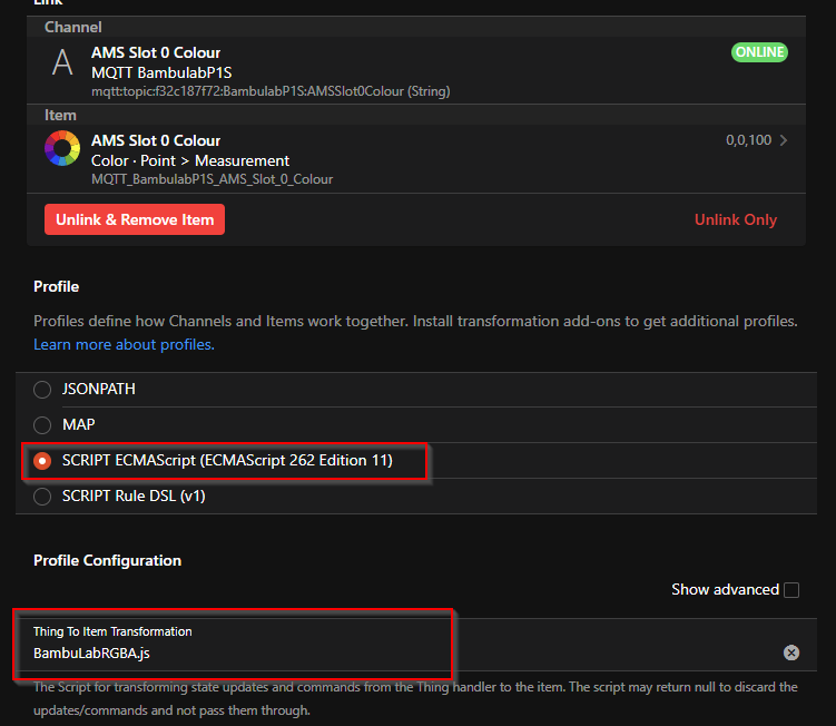

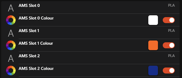

Many thanks for this - works flawlessly - at least with the current firmware of the printer :wink: . If you want the filament color displayed e.g. like this:
you need to convert the strings from the color channel to an HSB. I’ve used this script here (with a little help from ChatGPT because i’m lazy):
(function(input) {
    // Ensure the input is a string and has the expected length
    if (typeof input !== 'string' || input.length !== 8) {

and this script then is used for the channel profile
Wow, that’s awesome. I was thinking before how to display the colors but that’s not so easy.
I maybe being a little dumb here, but how / where do you create the script? Is it a matter of manually creating a file called (in your example) BambuLabRGBA.js into the ‘scripts’ folder’, or can this be created through and managed through UI?
