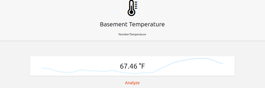

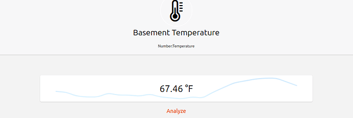

There are lots of ways, but the easiest is to go to MainUI → Settings → Items → Some Number Item and the default widget for the Item should have a sparkline behind the current state.
If you have a semantic model configured, you can click the “Analyze” or “Analyze All” option on any widget to see a chart.
