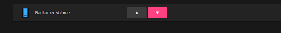

Hi, new to Openhab, installed v4 , i added a switch like below, it controls a volume , its actually an mqtt switch with no state…
But seems in OpenHab Basic UI, there is always a state if i press the up / down arrow (pink color)
How can i remove the color of the state there , so they both have same color, and not representing a state?
Switch icon=mediacontrol label="Badkamer Volume" item=volume_zone2 mappings=[ON="▲", OFF="▼"]

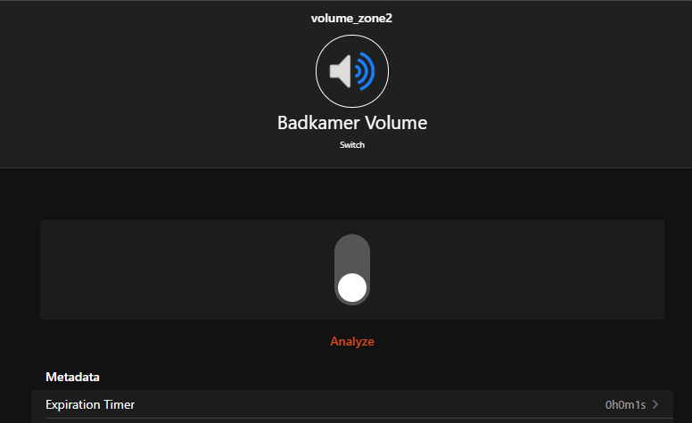

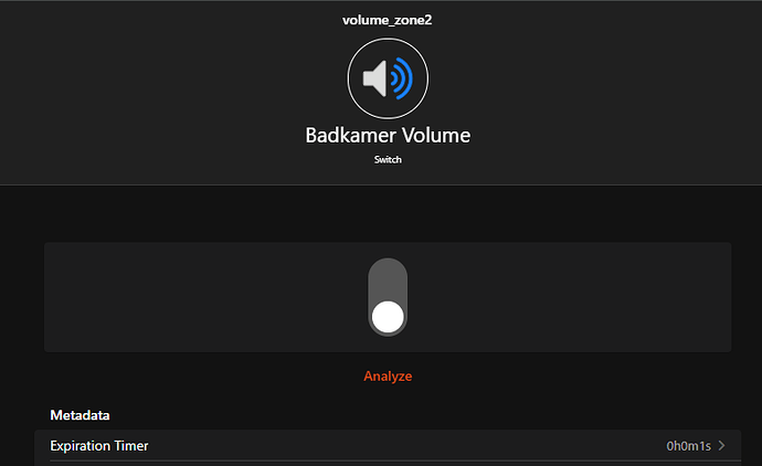

i have now created an expire timer, so the state goes back to none after 1 sec:

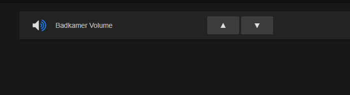

it now looks like below, thats what i wanted :slight_smile:
it only gets pink when pressed, but goes back to default after 1 sec…
good enough for me :slight_smile:

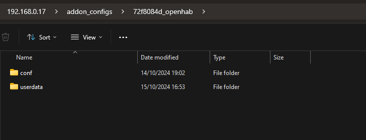

ah, i was looking for something in the UI itself, since i dun it on a docker instance
i have these folders mounted
i can copy over the .things file, cause i created them with yaml
conf\things
but what about the rest, where is the config located about items/sitemaps/… created in UI itself?
i copy the conf folder..
but the things, items, sitemaps that are created via UI you have to backup with the backup function of openhab itself.
i dont know how its done in a docker installation..
Everything is stored in userdata/jsondb.
As a general rule, if you mount folders into a container, the reason for doing so is that is the stuff that contains your data that needs to be preserved. So in general those are the folders you want to back up.
