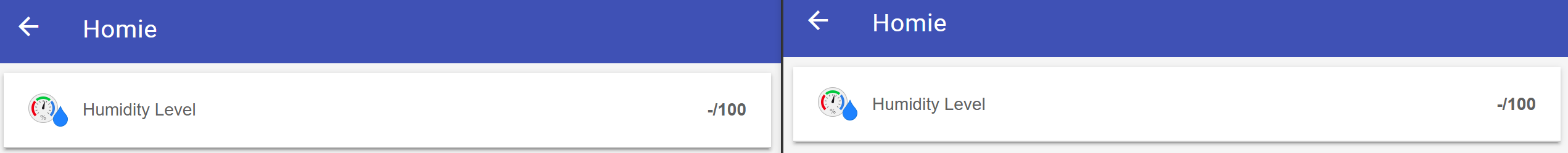

If you create an item in the items file, it won’t have a value initially. If you then go to Basic UI to see it, it will be shown, and have no value (as it should). If you then give the item a value, Basic UI won’t reflect it until you hit refresh… and at that point Basic UI will ONLY update that value if you hit refresh – not automatically!
I’m not sure what it takes to make it update – i’ve had to play games like cutting the entire items file, saving, then pasting it back in and saving again. That sometimes gets it working.

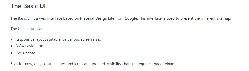

The only problem I see is you did not RTFM, especially the last line below.
from
https://www.openhab.org/docs/tutorial/uis.html#the-basic-ui
And you, sir, did not RMFP.
I’m not complaining that the item did not appear automatically. I’m complaining that it didn’t automatically update the state even after I manually pushed reload so that it became visible.

At first, I added my own group and item. Recreating it here as an example, and testing as I go right now.
I’m basing my syntax on the Wifi_Level item from the demo setup, because that one works, and updates on the fly.
Group Homie          "Homie Floor"   <smiley>    ["Homie"]
Number HomieHumidity               "Humidity Level [%d/100]"                 <humidity>        (Homie)
Then I added a group item to the demo sitemap, as the very first line inside the first frame, like so:

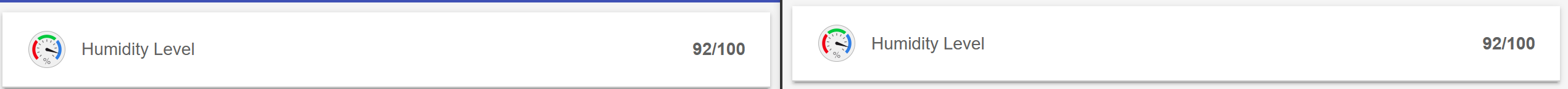

At this point I go to Basic UI and see what’s there. Today I will do it in both Firefox and Chrome, in parallel!
So far so good.
Now I edit demo.rules and add a line to the random wifi rule as follows:
rule "Set random wifi variations"
    System started or
    Time cron "/20 * * * * ?"
    postUpdate(Wifi_Level, (Math::random * 4.0).intValue)
	postUpdate(HomieHumidity, (Math::random * 100.0).intValue)
…and be damned. Both FF and Chrome are updating just fine without me having to reload.
Shroedinger’s cat, anyone? This is not what happened yesterday…

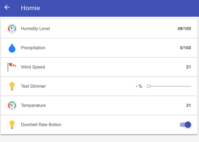

Now, for the first time I managed to link a button to an enum item on a Homie MQTT device!
Switch HomieRawButton "Doorbell Raw Button"   <lightbulb>         (FF_Homie)  { channel = "mqtt:homie300:ab60b3fb:nodeid1#doorbell" [profile="rawbutton-toggle-switch"] }
The log shows the HowieRawButton toggling on (or off) for every PRESSED-RELEASED sequence. Great!
Viewed from Classic UI, it works! The on/off switch in the GUI changes state.

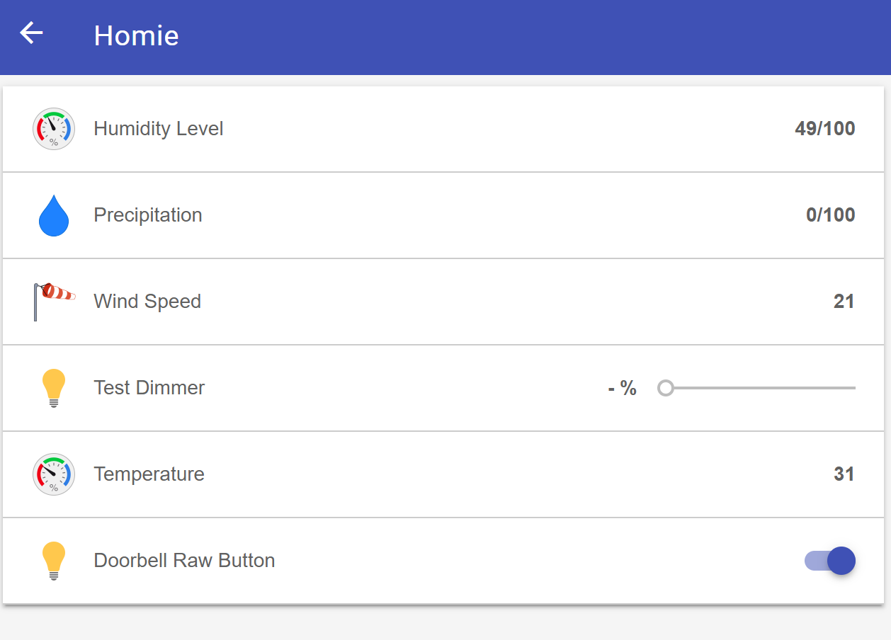

In Basic UI, it’s currently NOT updating. If I hit refresh, it updates, but it still will not update automatically the next time. This is happening in both Chrome and Firefox. Behavior is identical.
Then, for shits and giggles, I tried in Microsoft Edge. I’ve never looked at openHAB through edge before. IT WORKS. Somehow the Basic UI switch is updating on its own. And yet neither chrome doesn’t, nor firefox. I even tried to create a new private window in firefox.. Still won’t update on its own!
Visited from Chrome on another computer where I have never used it before… Still won’t update.
It’s not working reliably. I don’t know how much more proof is needed. It would be great if this could be fixed for M2.
Also, since I added that toggle switch, NONE of the items on that page are updating!
Humidity, Precipitation, Wind Speed and Temperature were all updating before! Now they’re all static until I hit refresh.
Update:
After restarting openHAB and refreshing the pages, it works perfectly in both Chrome and Firefox, including the toggle switch! So, it doesn’t seem to me like the problem is in the browser end of the chain.
