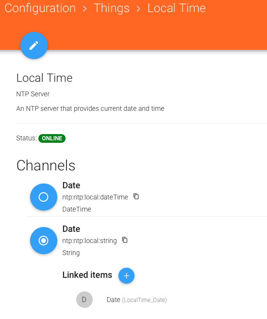

First I wanna Add Date and Time to the UI so I installed the NTP Binding, and I Add in Paper Ui a Thing
I can see the Time and Date in the Paper UI, but not in my Classic Ui:
                Frame label="Wetter Leipzig" {
            Text item=LocalTime_Date

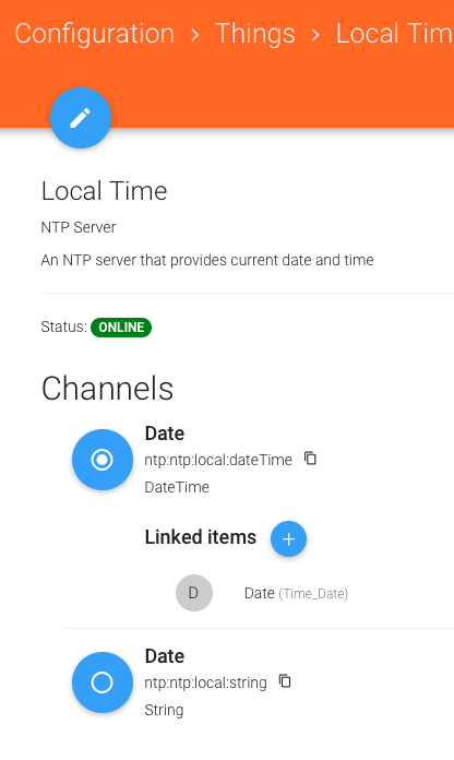

link the item to the top channel (ntp:ntp:local:dateTime)
https://docs.openhab.org/addons/bindings/ntp/readme.html#channels
Doesen´t Work :frowning:
Text item=Time_Date
