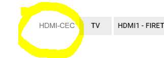

since a recent update the basic ui shows now the “item value” in front of the mapping list
even if a different label is set in the sitemap
this is not a label … but the item value
Yes, that is expected. If you don’t want the display of this value, just set your label to “my label []”.
@Lolodomo
I did set a label
there is a LABEL + the value
Mo … would be the label “Modus”
auto is the value
Yes, that is normal, you have by default the label at left, the value just at left of the buttons and the buttons.
If you don’t want the value to be displayed, use []
at end of your label.
now I understood it.
sorry!
works! thanks for the information!!
