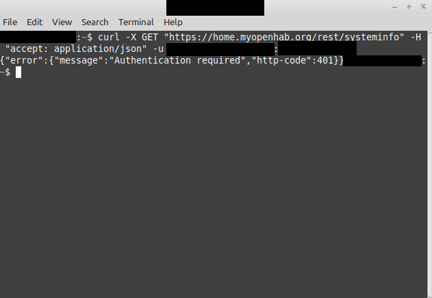

I use following shell command with my auth token but it returns “Unauthorized”:
curl -X GET --header "Accept: application/json" "https://home.myopenhab.org/rest/systeminfo" -u '{oh.myfirsttoken.123}:'
When I get it work using above bash/shell curl command then I will try to get same responses using php script.

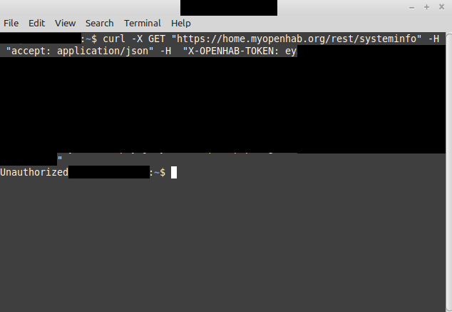

I have tried that before but probably using it wrong because when I copy/paste my command to my Linux terminal I also get “Unauthorized”:

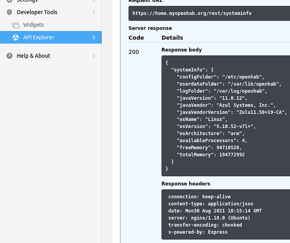

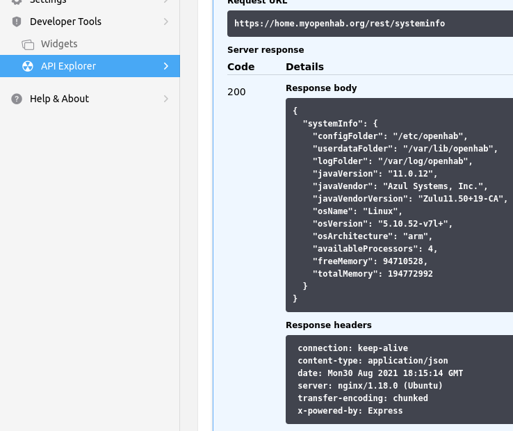

Same command generates correct response in myopehab.org API explorer:

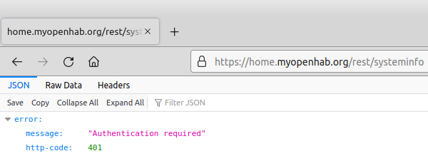

Well I am kind of lost here. I tried to get response via browser using this url: https://home.myopenhab.org/rest/systeminfo
After entering that url into browser I was asked for username and password and after I submitted it I was shown this content:
Similar outcome obtained when using Linux terminal and curl command with username and password provided in one command (instead of token):
