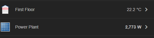

To eliminate this as an artifact of Text widget rather than a property of Group type Items, try
Group item=FF_Temperature label="First Floor" icon="firstfloor"
Text item=FF_Temperature label="text with subpage" icon="firstfloor" {
Text item=FF_Temperature label="text no subpage" icon="firstfloor"
Text item=PVE_Now label="Power Plant" {
seems to be unnecessarily complicated…
as I’m using Groups for grouping items, I probably will be using Groups instead of Text everywhere… it’s quite weird, but bold+regular on one sitemap looks even weirder tho
It’s just a test to find out what presents as you like it.
I had a play and this effect does not show up in ClassicUI (I usually use, preferring the single column form). No bolds at all.
I would say this is a bug in BasicUI Group widget, which does not present formatted state like other widgets.

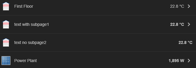

to your suggestion:
Text item=FF_Temperature label="text with subpage1" icon="firstfloor" {
Text label="text"
Text item=FF_Temperature label="text no subpage2" icon="firstfloor"
Text label="text"
Okay, so it appears to be an issue with Group widget (and not about the subpage action itself).
As I said, I think that’s a bug in BasicUI (the behaviour in Classic UI is not like that).
Someone might want to check the andoid and IoS apps, for comparison.
If all values are rendered in bold, the group value should be too.
