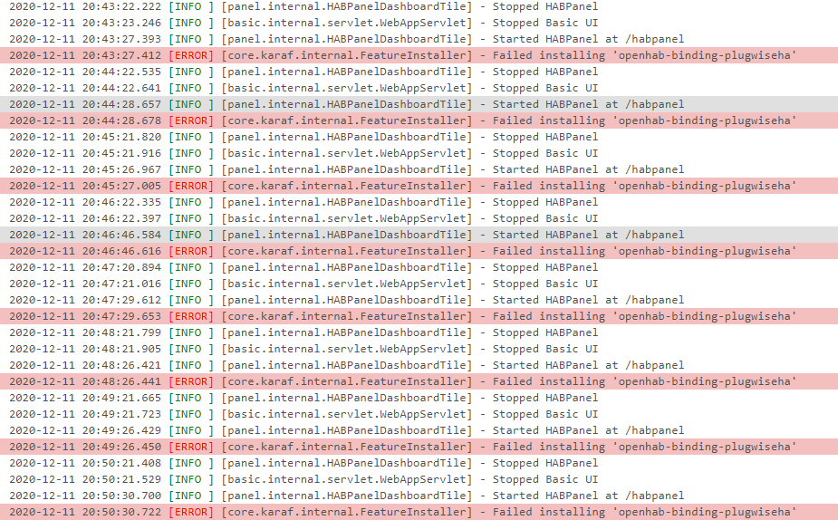

Having this issue since a few weeks now, and can’t seem to get rid of it:
  • The issue with the “plugwiseha” is not the cause, I uninstalled it, and it was also not solved.
It affects my HABPanel, as it gets disconnected almost constantly.

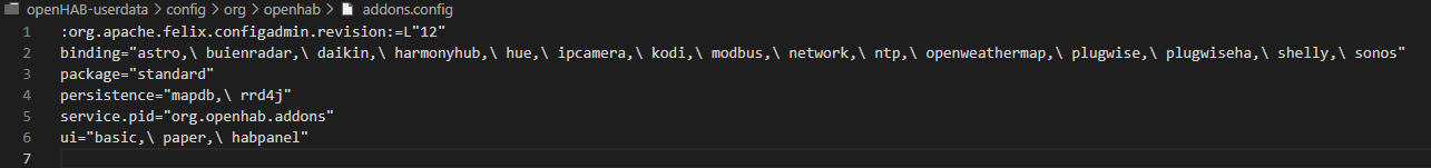

the “addons.config” looks ike this:
:org.apache.felix.configadmin.revision:=L"12"
binding=“astro,\ buienradar,\ daikin,\ harmonyhub,\ hue,\ ipcamera,\ kodi,\ modbus,\ network,\ ntp,\ openweathermap,\ plugwise,\ plugwiseha,\ shelly,\ sonos”
package=“standard”
persistence=“mapdb,\ rrd4j”
service.pid=“org.openhab.addons”
ui=“basic,\ paper,\ habpanel”
Anything suspicious in there?
What are all these backslashes doing in there? Should look like this:
binding="astro,buienradar,daikin,harmonyhub,hue,ipcamera,kodi,modbus,network,ntp,openweathermap,plugwise,plugwiseha,shelly,sonos"
package="standard"
persistence="mapdb,rrd4j"
service.pid="org.openhab.addons"
ui="basic,paper,habpanel"
What editor did you use to show that content? Please use an ascii editor, not ms word or something alike.

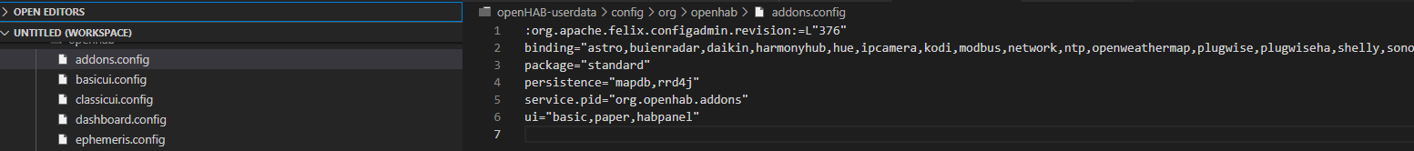

I opened the file in Visual Studio code, where I always do my editing:
Please remove them:
and make sure your VSC is set to UTF-8 (lower right corner):
grafik
Removed them, no luck.
UTF-8 was like that…
Did you restart OH after changing?
Not only the spaces, also the backslashes :slight_smile:
Yep, everything. Looks like this:
After full reboot, no result… I even cleared the addons.config file to only the bindings but it kept happening.
binding=“astro,buienradar,daikin,harmonyhub,hue,ipcamera,kodi,modbus,network,ntp,openweathermap,plugwise,plugwiseha,shelly,sonos”

**EDIT 14/12/2020: It seems that the app on my Samsung Tab, “Habpanelviewer” isn’t running at the moment, and the error in the logs seem to have dissappeared. I’ll investigate this further and keep this post updated. I only get them when I edit the HABPanel and save/run it. So those are controlled-logitems.
