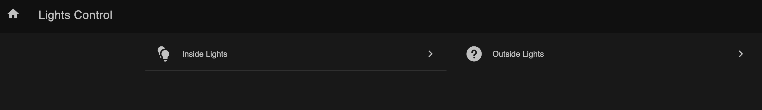

Using the semantic model, I can generate a basicui sitemap that shows all my lights, grouped by each room. In this example, I only included the switch control, but it can easily be extended to include dimmer/brightness, color picker, color temperature, etc.

In contrast, this is how I did it previously using a sitemap file:
sitemap lights label="Lights Control"
Group item=gInsideLights label="Inside Lights"
Group item=gOutsideLights label="Outside Lights"
And this is how it would look - no grouping for each room / no correlation with the semantic model. It’s just alphabetically sorted.
