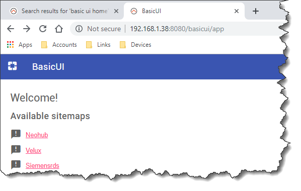

BasicUI allows one to have multiple sitemaps; and in the top level “home” screen it allows you to select which one to load as shown in the image below..
However, once you have selected a specific sitemap, there seems to be no way to navigate back to the top level “home” screen again; I would have expected that the house icon would be linked to the top level home screen (see NOT image below)..
Is there a reason for this? Or is BasicUI basically broken?

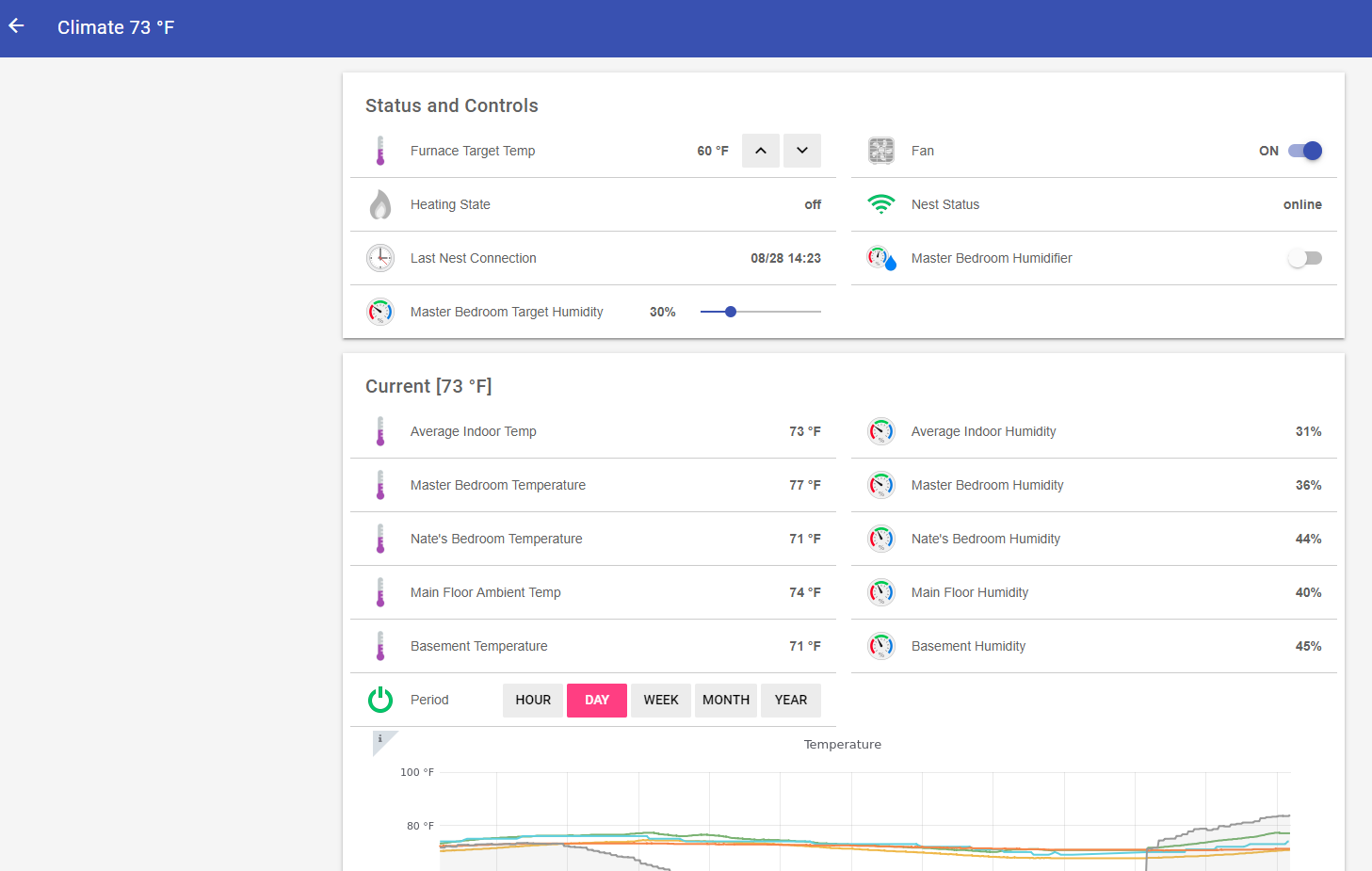

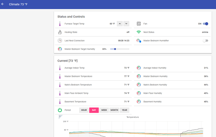

Not Groups. Groups give you no control. You want to use Frames and subelements. For example:
                Text item=gIndoorTemps label="Climate [%.0f °F]"{
                        Frame label="Status and Controls" {
                                Setpoint item=aNest_TargetTemp minValue=50 maxValue=75 step=1
                                Switch item=aNest_Fan
                                Text item=vNest_State
                                Text item=vNest_Online
                                Text item=vNest_LastConnection
                                Switch item=aMBR_Humidifier
                                Slider item=vMBR_Target_Humidity
                        Frame item=gIndoorTemps label="Current [%.0f °F]" {
                                Text item=gIndoorHumidity
                                Text item=vMBR_Temperature
                                Text item=vMBR_Humidity
                                Text item=vNateBR_Temperature
                                Text item=vNateBR_Humidity
                                Text item=vNest_Temp
                                Text item=vNest_Humidity
                                Text item=vBasement_Temperature
                                Text item=vBasement_Humidity
                                // Temperature
                                Switch item=ChartVisibility mappings=[h=Hour,d=Day,w=Week,M=Month,y=Year]
                                Image url="http://argus:8080/static/temp.jpg" refresh=1000
                                // Humidity
                                Image url="http://argus:8080/static/hum.jpg" refresh=1000
Pay attention to the curly brackets. When you create an element (e.g. Text in this case) and supply curly brackets, everthing defined inside the curly brackets is put in a subpage of the sitemap. In this case, the indoor climate information for my house. NOTE: this subsection pasted in above is not complete, you must have a closing } for every {.
Clicking on “Climate” leads to
Clicking on the back arrow goes back to the previous sitemap page.

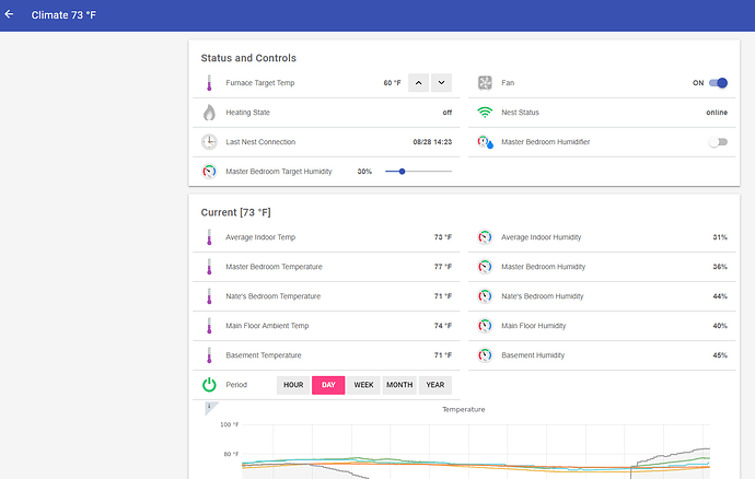

Thanks @rlkoshak for the good advice about how to navigate DOWN the branches of a tree; this is very helpful. Nevertheless my question was actually about how to navigate UP to the top of the tree. Apparently (oddly) the advice is that OH has no way to navigate to the top of the tree, and the advice is (strangely) only to use the browser back button, or a bookmark. Really??
If you look at my screen shot, you will see a back arrow in the upper left corner. That navigates back to the previous screen. If you are two it more screens down, indeed, there is no way to jump straight to the home screen.
