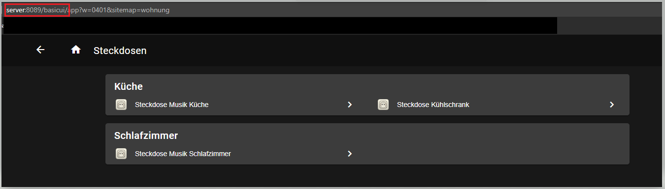

I also wanted a Home Button to go back to my default sitemap from every subpage. So I build my own css and javascript to solve this problem. It based on this post here: Customizing Basic UI with CSS
Now the Home Button ( house in the left corner ) will be visible all the time and will direct you to the base uri of your sitemap. The url could also be changed.
See:
The picture show subpage. If you click on the arrow you will go just one step back, if you click on the house you will go back to the base uri, red framed part off the url.
The additional part you have to add to your own css file:
